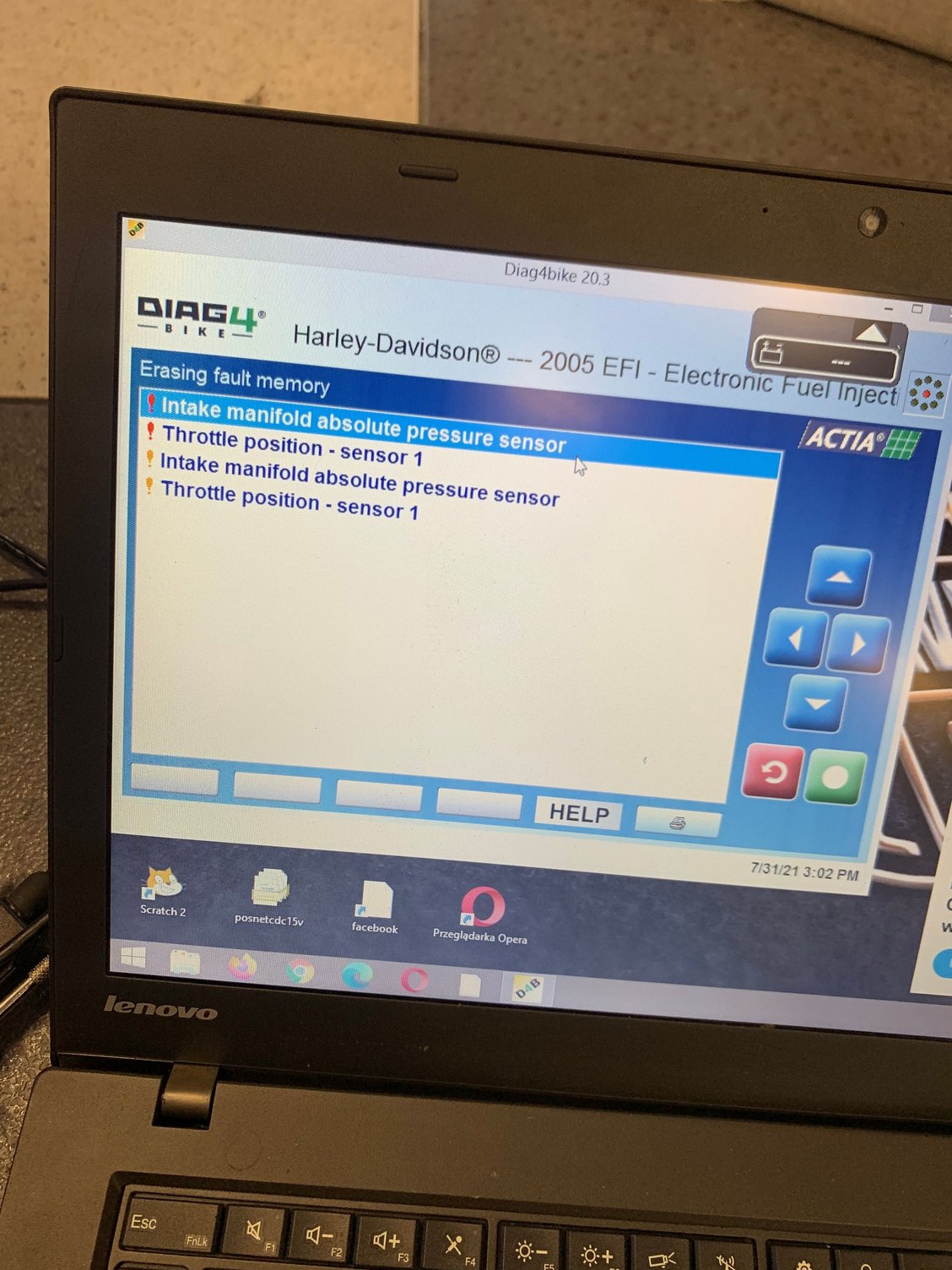

I have a problem with dyna 2006. Bike is starting well, but cant ride it. It is choking, caughing etc.
Computer shows throttle sensor and map or manifold sensor.
what i already replace:
-ecm
-map sensor
-throttle sensor
-ecm connector
-injectors
-fuel pump and fuel filter (were totaly shitty)
-there is No 5V on ecm pin 14
-checked connection between ecm and sensors
what should i check to give to sensors 5V?

I check diagram and it shows 5v on 14pin

Looks like pin 26 is sensor ground, might be isolated from chassis ground. When checking sensor 5V you might need to put the meter neg lead on pin 26. If you don't have the 5V at the sensor the ECM will not get a signal from the sensor.

Digital grounds used in the ECM will be isolated from the chassis ground to prevent the voltage regulator from passing current to the ECM through the ground. If you have no 5V sensor voltage none of your sensors would be working.

Update
it was speed sensor problem:/
