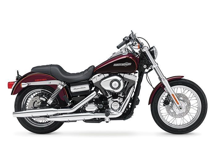

I assume you mean this style? I don't know if these will work with the further forward mids, but someone has to have tried it. Maybe some careful measuring of a stock Super Glide/Street Bob will answer your question.

Yes the stock head pipes work with further forward controls. I have a set with the V&H slash slip ons and the stock mufflers that came with the bike.
Old Aug 19, 2021 | 06:33 PM
Qdog002's Avatar
Qdog002
Joined: Nov 2012
Posts: 3,517
Likes: 893
From: Upstate New York
Here is a picture

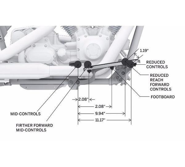

So... what are further forward mids? I don't think I've ever seen them.
Old Aug 20, 2021 | 01:18 PM
Harleywashboy's Avatar
Harleywashboy
Joined: May 2018
Posts: 193
Likes: 51
From: Cumming, GA
They came factory on the 2014-2017 lowrider I think. Image of foot positions available for dyna's from the factory.
