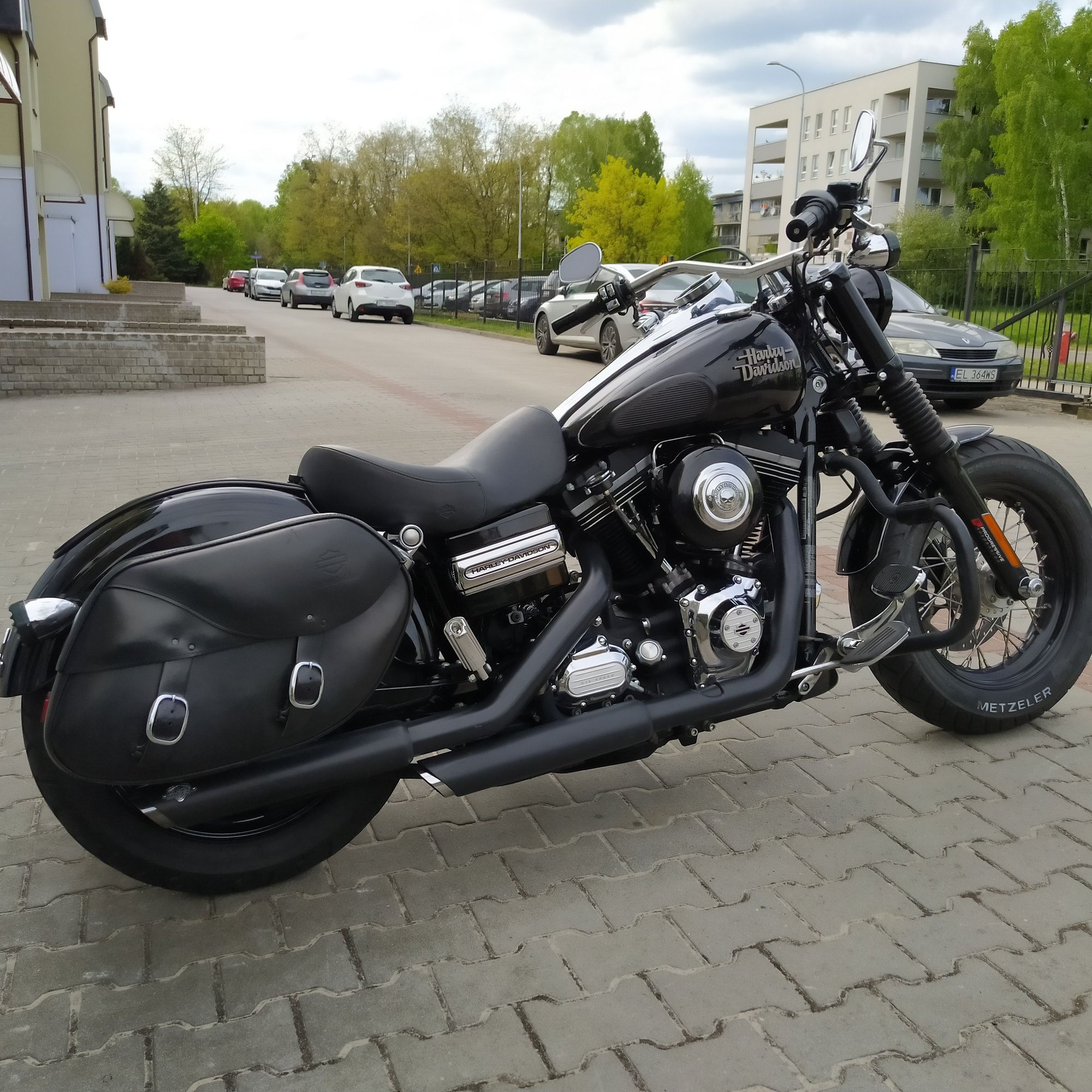

Originally Posted by Ninjanav
Hi,
1.Can I replace the wheel & tyre of my street bob with the one's on Fat bob?
You can just change the front rim. This is mine FXDB with 3,5x17" rim.
The widest tire you can put on is 150mm without changing triple trees.

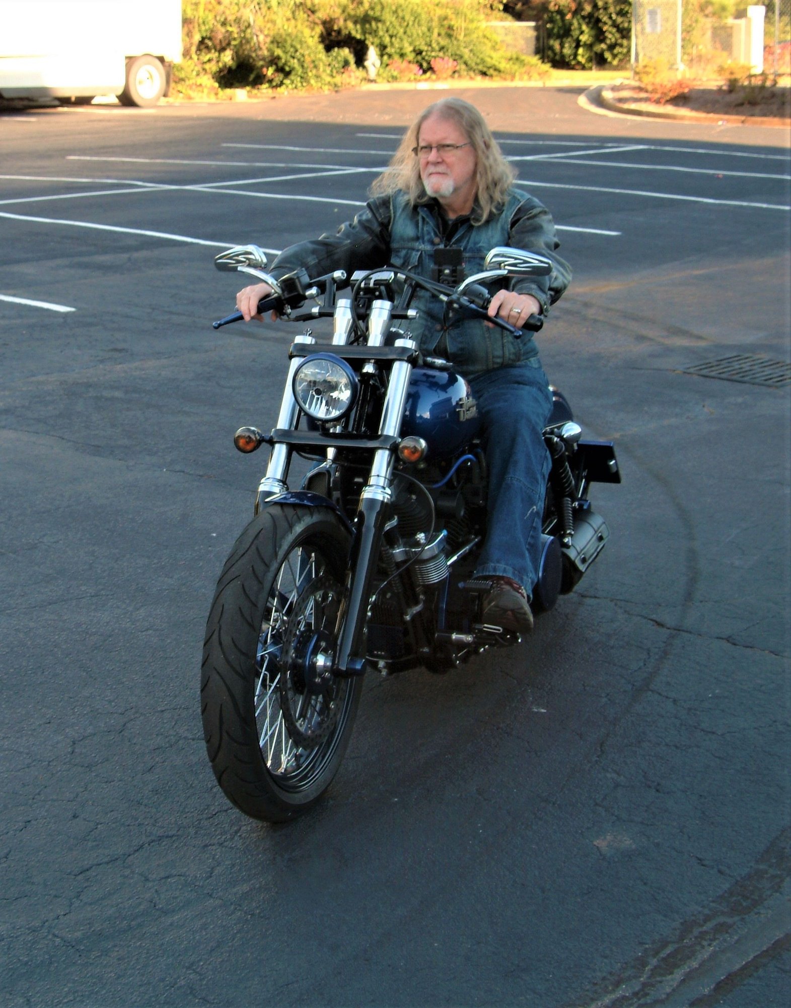

Originally Posted by jamesw1301
Are you running wide glide or fat bob triple trees on your bob?
FXDWG Tree's
