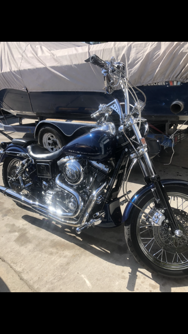

So what im wanting to do is replace my stock spoke wheels F 19x3 / R 16x3.5 from a 2000 dyna super glide sport to the Road Glide FLTR Enforcer Wheels 2014-2019 F19" R 16" I believe the rear is 5" width so Mt question is can I make the switch ? is it possible, if so what do I need to do to successfully accomplish this ?​​​​​​​
My current wheels
what I want to switch to

Hopefully Multihdrdr will pop into this thread, as he's the forum interchange guru, but I'd say at a minimum you'll need a Wide Glide width front end and different bearings. No idea on rear fitment.
