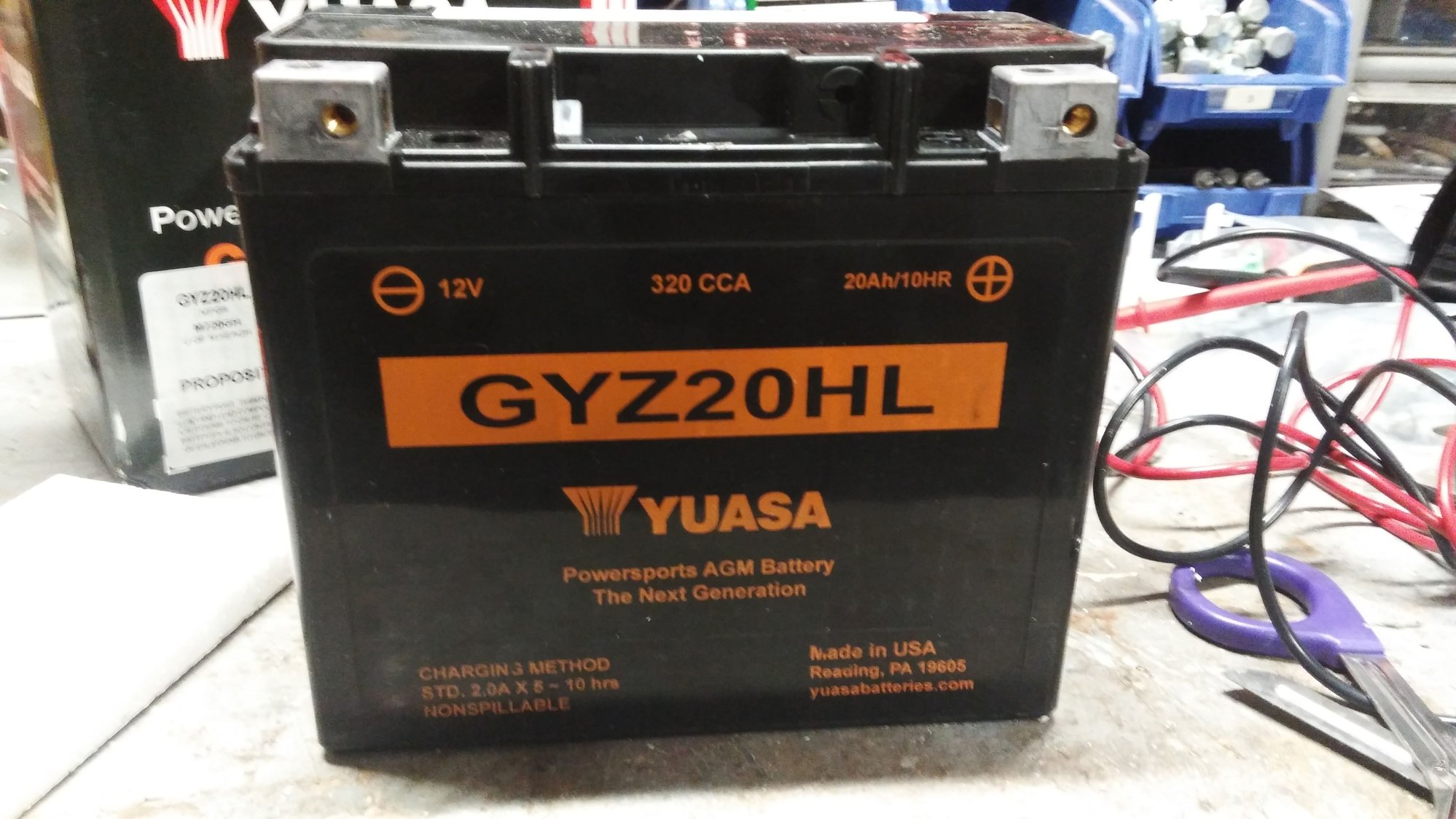

Mine did the same thing. I replaced it with this

If it's the original battery, it's 9 years old. It doesn't owe you anything at this point. Stock HD batteries are underpowered IMO. A 10 horse lawn tractor has more CCAs. I went with the YUASA above. Was thinking of going with a scary flammable lithium ion battery for more power but didn't bother because 1, Scary flammable, 2, need a special charger, and 3, they lose their chi if drained too low/aren't good for cold weather. Would like to hear if anyone is running one of these and likes it.
