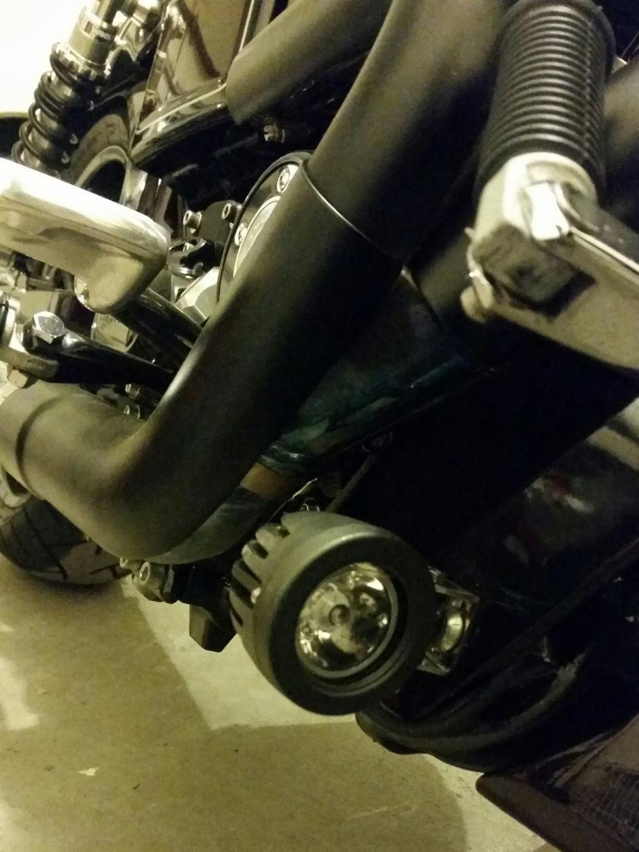

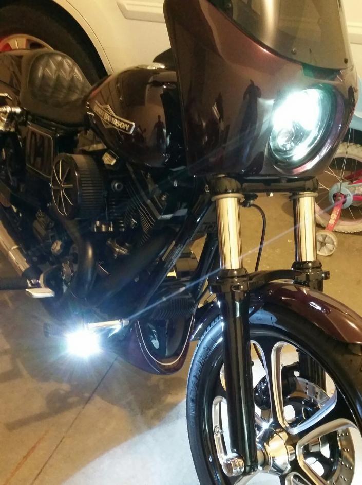

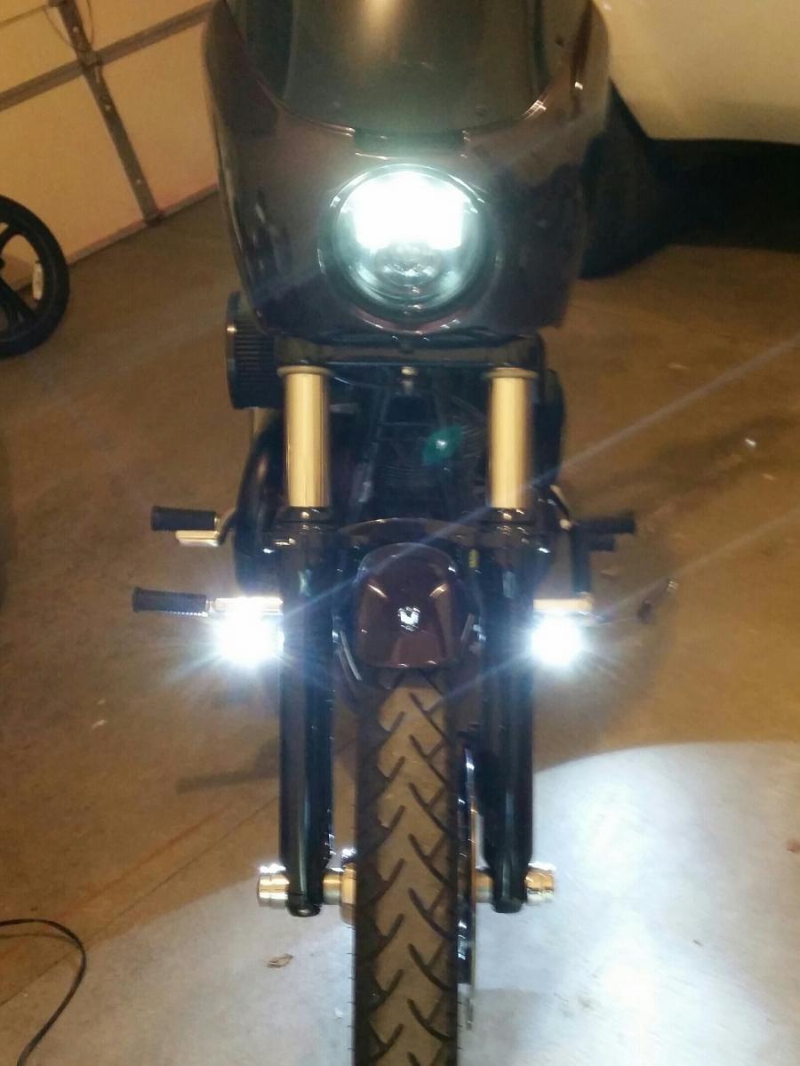

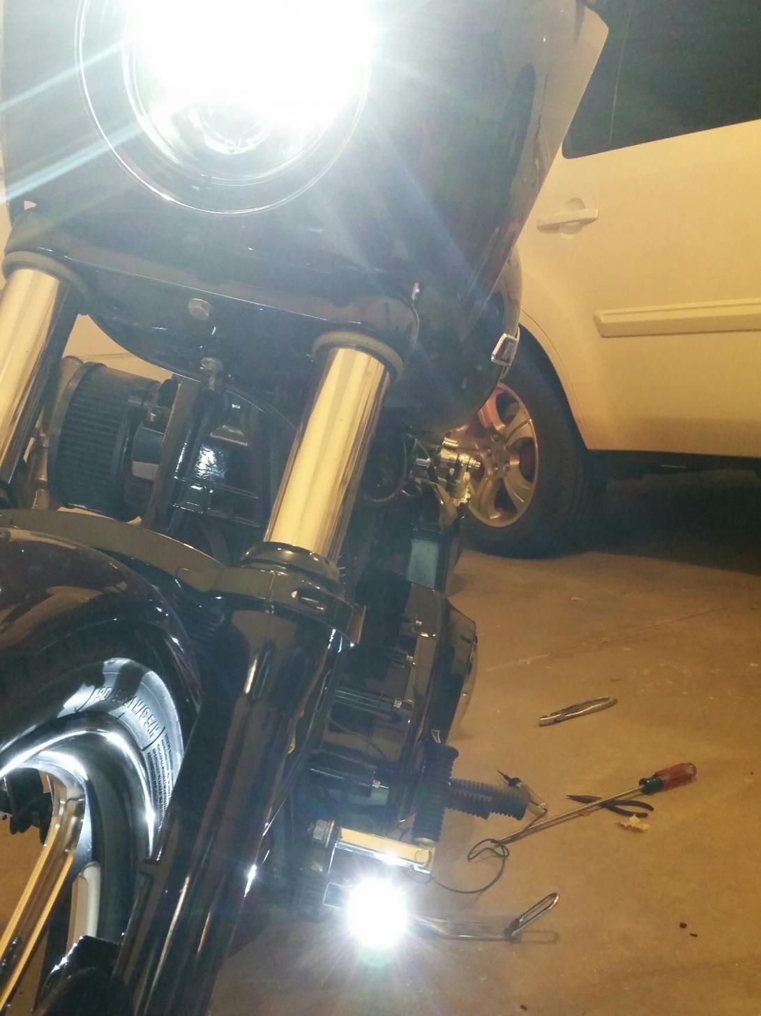

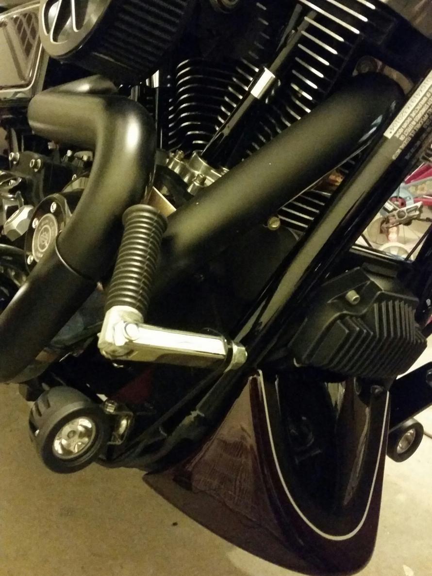

Never mind, I see it's a 2011. I'm not sure the passing lamps would fit without notching the fairing. Have you considered the small LED light bar under the lower triple tree? I run one on my FXR and it makes a world of difference. I will be putting one on my 2006 FXD35 as well. I've also seen people mount small LED fog lights down on the fork tubes as well as down on the frame where the forward controls mount. Just a few options that may require a little fabrication and ingenuity to figure out. The light bar under the lower triple tree is by far the easiest. Just gotta wire it in. Kuryakyn makes a relay and switch kit that works well.

Not my photos, some that were found on another thread.
