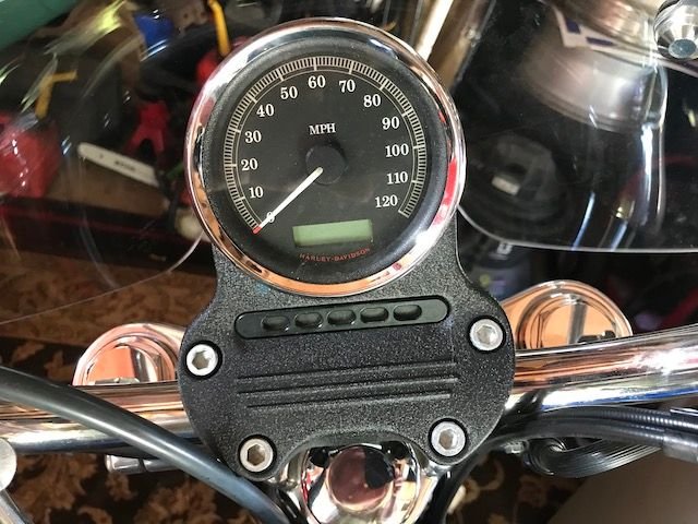

I have a 2007 Dyna Superglide that I would like to add a Tachometer to. It originally came with a single speedometer gauge mounted above the handle bars. See picture below.

I have purchased the "Mickey Mouse Ears" bracket, the handle bar bracket and a Tach, PN# 67042-04A, but I can't seem to find a harness to make it work. I did purchase a Road King harness, which connects into the Tach ... Could it really be that easy? I have attached the .pdf wiring diagram below. (Untitled 2)
It appears that you have the correct Tach so yes, it really could be that easy ... As long as you connect the 5 wires correctly.
All you're effectively doing is using the same year FXDL wiring configuration (and Tach) and relocating the Tach to the Bars
