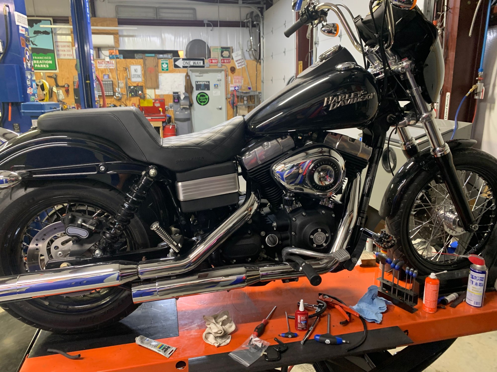

Tried to change from öhlins 305 mm to öhlins 336 mm , no room over rear muffler.

According to your sig you have S&S Grand National slip ons? I can see where they may contact the lower shock mount bolt if they are a lot fatter than stock. I have Ohlin’s 336mm (13 1/4”) Blacklines on my FXDB with stock pipes and there is no clearance issues.

That sounds plausible, but I measured ,close to 83 mm on both .S&s and stock.
