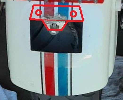

Originally Posted by Iceman24
That's what I was thinking, but wouldn't the same part on a Dyna be compatible...buying HD parts vs. McGruber welding?
Well I suspect that he bought the new tail light due to the original flopping around from the broken tab and getting all scratched up..
I guess he could simply epoxy the tail light to the fender.. It would require a repaint if it the tail light base ever got screwed up..

Sorry... it's the small white piece with the screw in it . It was a part that was welded to the inside the fender, that's the small piece that holds the whole tail light on
yes , the whole assembly,the old one I super glued back together , till all is repaired then put he new unit back on

While the OP really didn't do a good job of explaining what was broke, it looks like he's trying to epoxy the tab that holds the tail light base on . I wouldn't expect epoxy to hold as shown. OP might get away with epoxying a tab if the tab was re-made with a large lap joint (say about 4-6 square inches on the inside of the fender.
The repair probably should be be welded. From what I can see the weld paint burn can be covered up by the tail light base if the heat is controlled with damp rags. In order to do the weld the tab should be welded from the back which means removing the fender.
I don't think that the taillight bas is pot metal. For the last 20-30 years, it's been made of plastic.
its plastic all right (the base) if nothing can it be Mig or tig welded back on

The tab can but the plastic can not..

Make a mount for the backside of the fender and pop rivet it on, or match drill the tail light base to the fender and bolt it on.

I personally will not be able to make a piece to rivit on that's why I'm now calling a professional to repair it like original. What a poor design.

There is only about an inch above the screwthat would be covered by the base

Well I have a welder coming to my home in the morning to possibly tad the piece back on. I'll get back later

Wow, had a pro come over to do the work, and he did a GREAt job. He used a MIG on it and what professional work he did ....it looks like nothing has happened, looks original. you cant tell it was messed with it . sorry i didn't take a pic. his charge was $85.00. took his time probably a good hr. grinding and tacking and filling. I am so happy. gave him $ 100.00 and took some cards from him. put the brand new tail light back on with a smile
