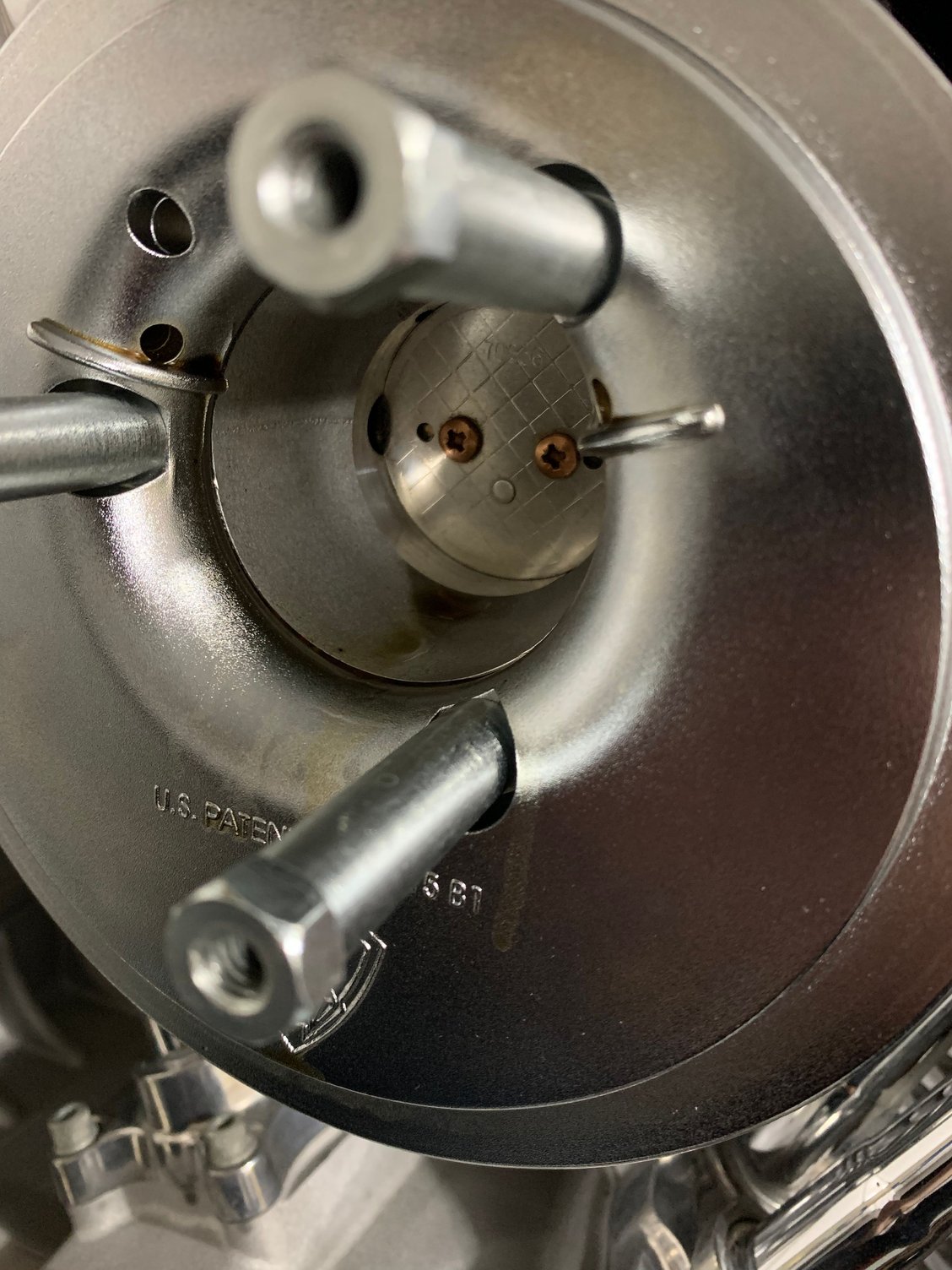

I have a 2007 Super Glide and it’s beginning to give me some issues. Lately, I’ve noticed that at low idle (mainly at stop lights), it’ll die on me. If I’m lucky, it’ll just idle really low and just spudder like it WANTS to die. I took off my air cleaner, and there was a decent amount of oil present (photo). I cleaned that up, and would ride fine; essentially how it should. After about 90-100 miles, same story.
I read online that this could also be a TPS issue. Has anybody else experienced this. And was it truly the TPS?
I should note that this only became a problem when I switched out my forwards to mids. Could it be something as stupid as overfilling the primary slightly?

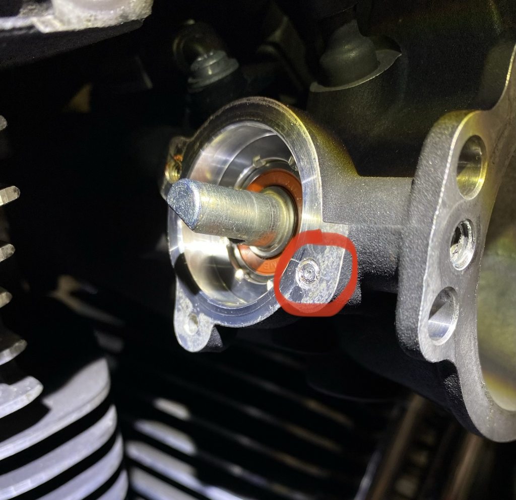

I bought a rough 2011 FXDF as my first HD and while I had auto repair down, these "rides" are new to me.
as I was cleaning my engine up, I noticed a lot of oil in the air cleaner, throttle body. I read and received alot of info on oil back into the induction system.
Eventually I got an error code on TPS. I removed mine and it was heavily saturated/coated with oil. Here comes the nightmare.... one of the new screws broke off into the throttle body, but I got it fixed.
I purchased a new TPS, set up a catch can system, blocking oil ports back into the induction system and a forum buddy suggested I remove one to two squares of oil (dipstick level).
While my breather filter seems clean, I think the reducing of my engine oil top off 1.5 squares really helped.
hope this helps
Added.... I ended up removing the induction system, to clean it out and replace seals. glad I went in that direction... they were about to fail. Both rubber seals from induction to jugs were completely coated with oil.
