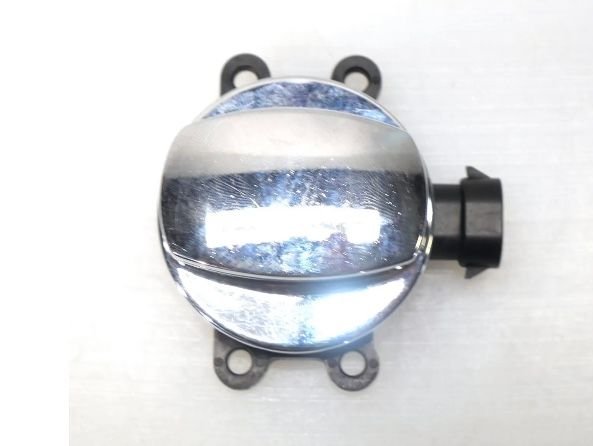

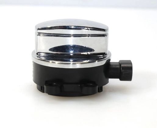

Does anyone know how to disassemble the chrome part of the ignition switch from the plastic part? Trying to powder coat the chrome. Don’t know if it is possible to separate the two. thanks

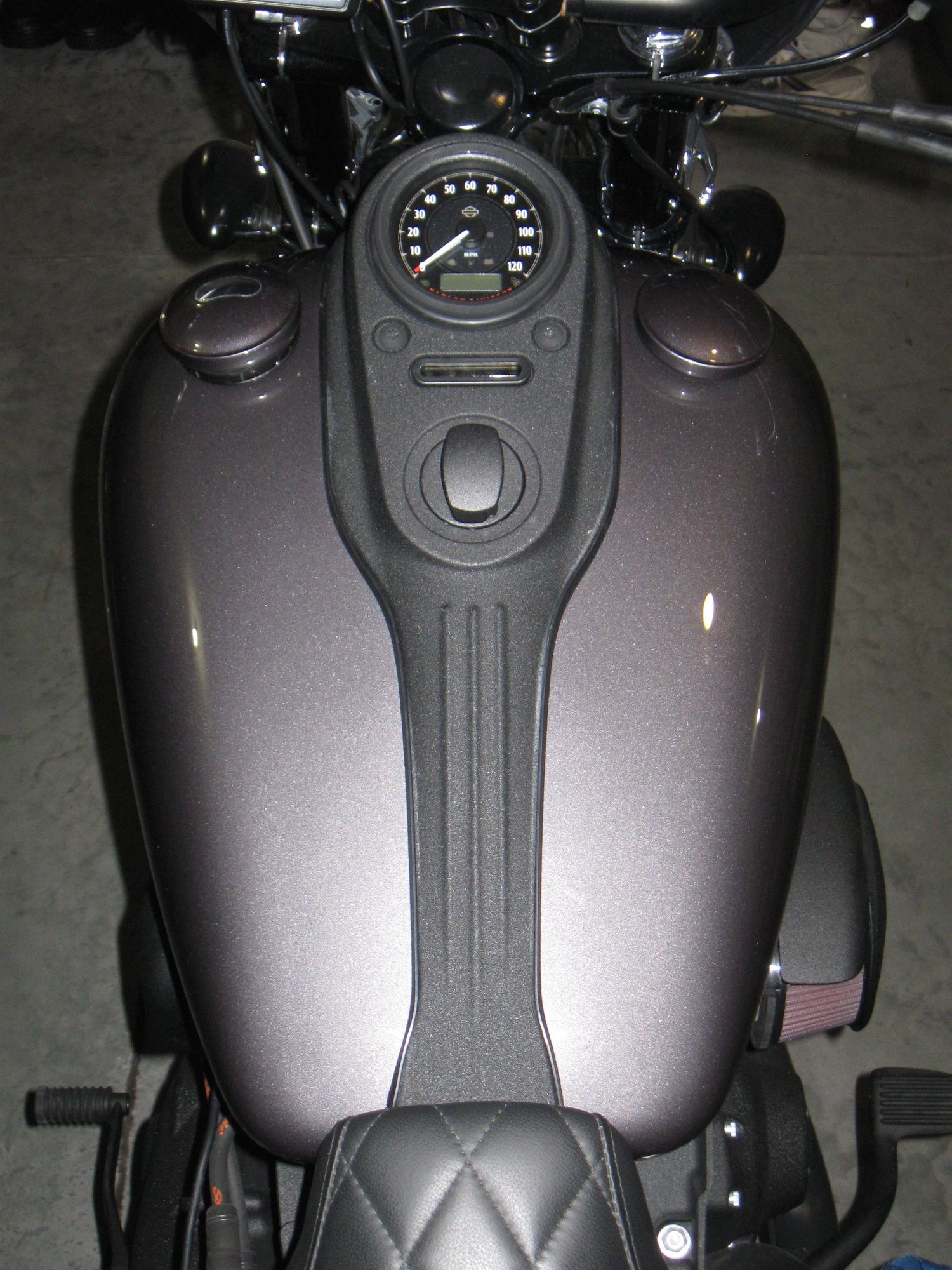

Thanks for the compliment, the trick is I had the gas caps painted to match, that's the real magic! For folks with black paint not much they can do since they can just buy black caps but if you got some paint with a nice color then that's the ticket! Mine's just OEM charcoal pearl but even then makes a world of difference. And for those that have a color and they leave them stock like chrome or stainless whatever.......yawn fest

Well I was able to disassemble the part. Just take a thin screw driver and you are able to lift the back off. Put the screwdriver in the three openings in the back. It should release the back and it should slide up. After taking the back off it reveals a circlip that holds the chrome piece on. Removed the circlip and the two parts are separated. Ended up cleaning the inside out because Harley just slabs a bunch of grease in there. I’ll probably put some dielectric grease in there when I put it back together. Just fyi if anyone was having difficulty trying to disassemble the ignition switches with the closed back.
