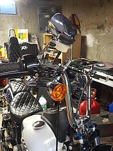

It really depends on how deep you want to go. In my case nothing Harley is left for the brakes. I used a Brembo 19RCS master cylinder, had Spiegler make a set of brake lines to my specs, radial calipers off an R6, speed merchant mounts for them, and Brake tech floating rotors. I did have to make a few spacers to get it all lined up but you can get by with stacking washers just doesn't look as good. It's more braking then I will need but it's there. Entire systems was a little spendy but I feel it was worth it. I really like the brembo master. One thing to consider but I think you may be safe (others here know for sure) is if you have the canbus system like my 2015 you will need to buy a brake light switch for the master. Harley went opposite the rest of the world so the supplied one from brembo works backwards.

Are your fork seals exposed in that picture???
It's not the seals it's just the wiper but yes they are exposed. The chrome covers only make it harder for any moisture to escape and could cause rust issues which is what I had when I swapped out the lowers to go dual disc.
