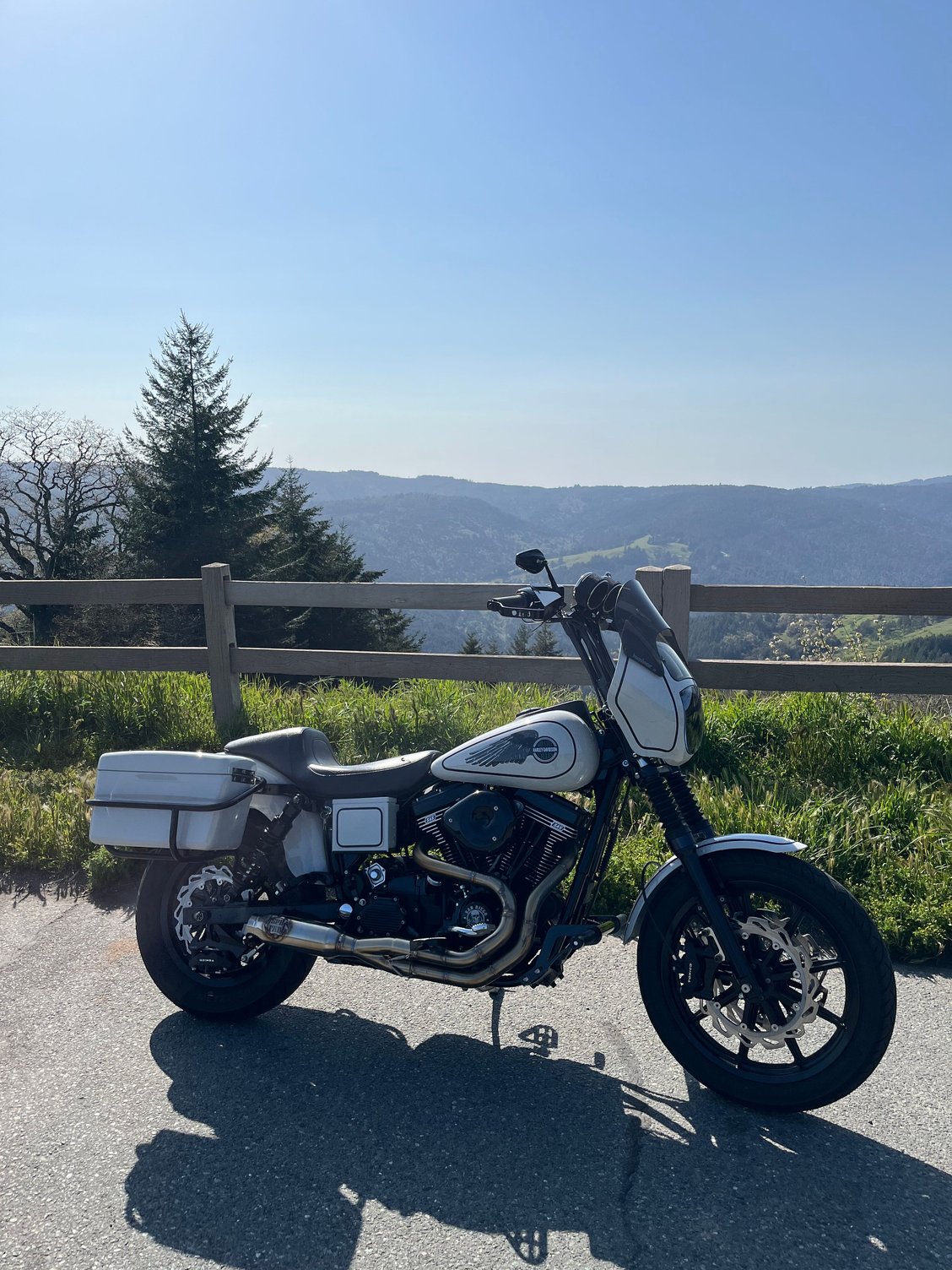

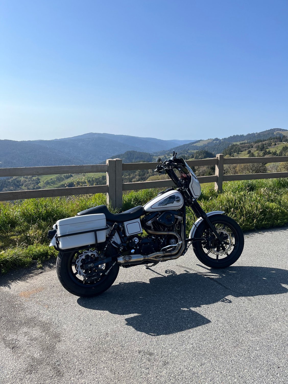

This is a 97 fxd. I just started with bars an riser then front and rear shocks and so on. Really depends on how far you want to go down the rabbit hole.
