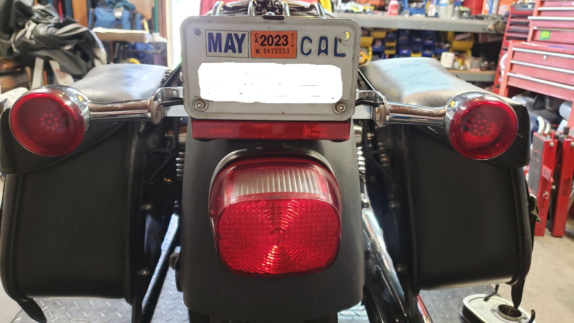

Old Mar 21, 2023 | 06:10 PM
Tom H's Avatar
Tom H
Joined: Dec 2022
Posts: 822
Likes: 488
From: LA Ca.
I have a '07 Street Bob. I looked at the tube style kit, it might be a bit cleaner looking, but you have to mess with the wires more. I bought this one:
https://www.ebay.com/itm/144675398933?var=443913714533
Just needed to remove the connectors from the turn signal wires so that I could get the wires through the holes. Just Google "harley turn signal relocation kit instructions" and you'll find the instructions for the tube style. With this one, no wire cutting needed.
The only thing I had to do that the Harley kit includes was to drill a hole in the license plate mounting bracket for the wires to pass through.
Took about an hour or so, wasn't in a rush to get it done.
Hope this helps,
Tom

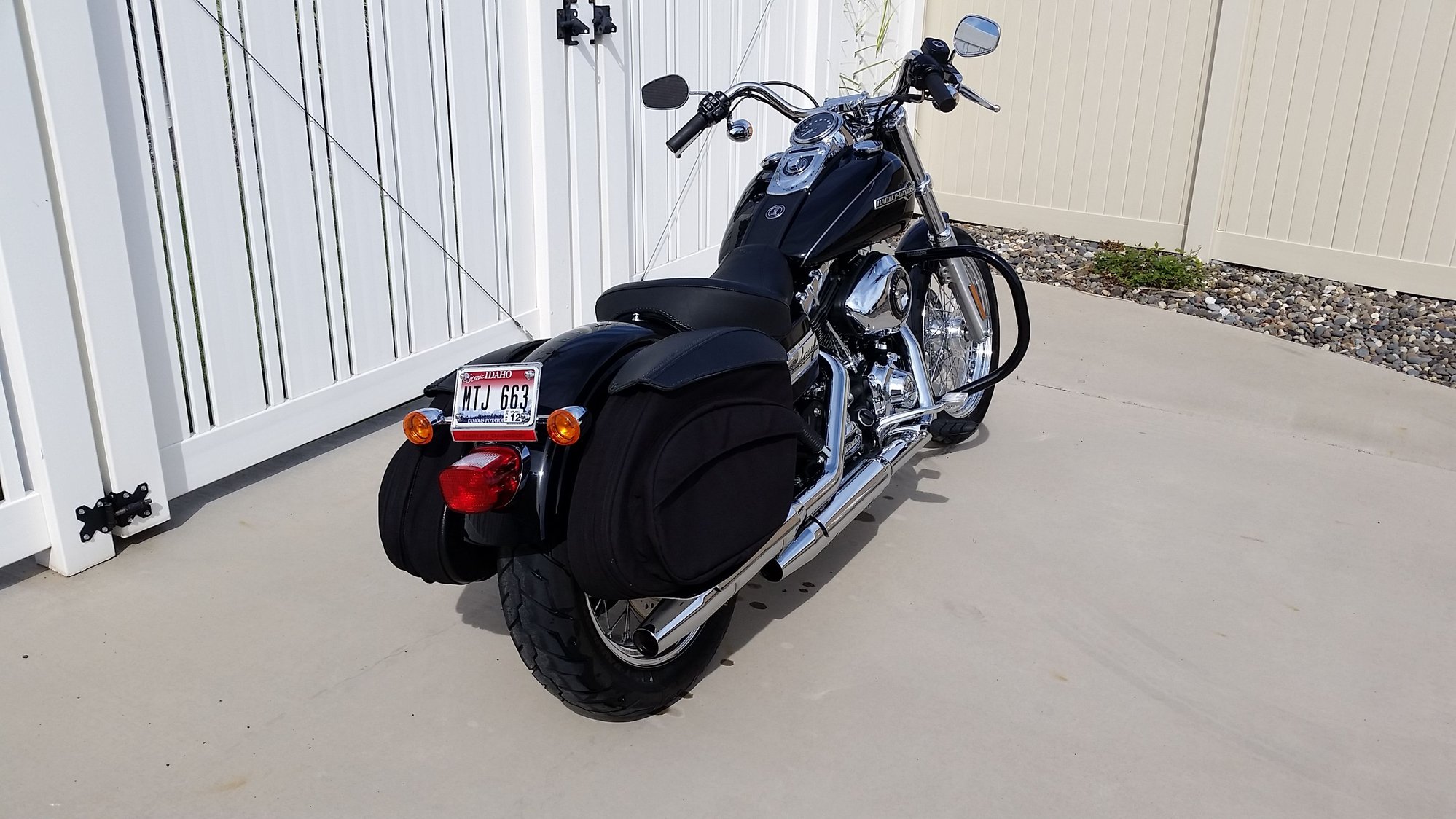

Old Mar 21, 2023 | 07:04 PM
Tom H's Avatar
Tom H
Joined: Dec 2022
Posts: 822
Likes: 488
From: LA Ca.
Crazy, I almost went with that style, maybe I shoulda. Looks good.
Tom
