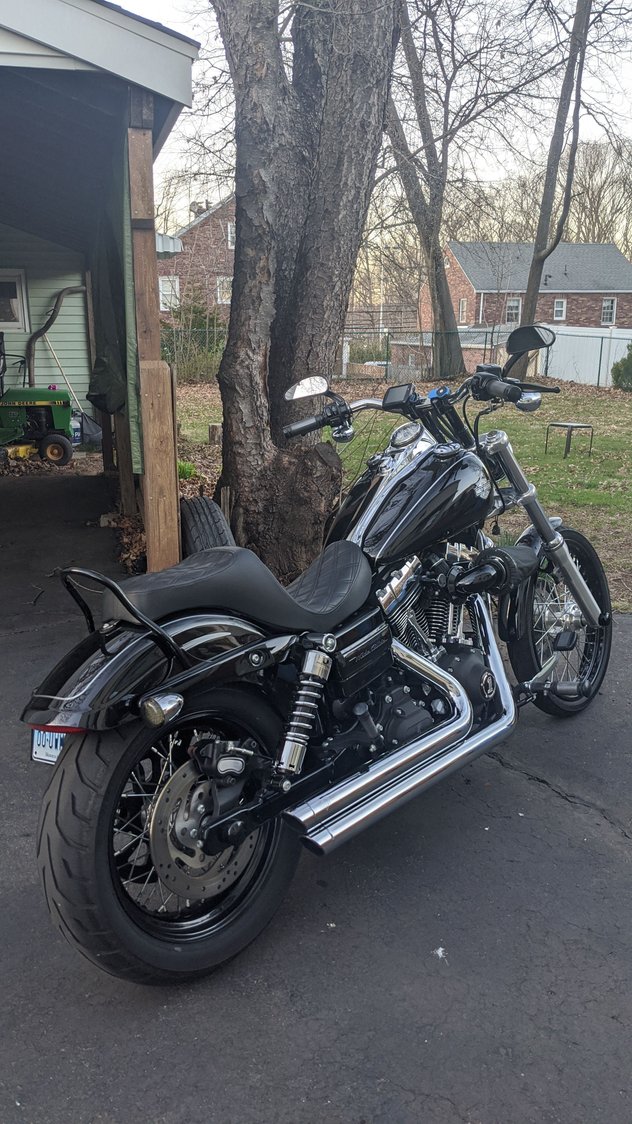

I have a 2010 dyna wide glide with factory suspension. I am curious how taller rear shocks would look and perform but it seems like most people go the other direction and lower the rear.
I am thinking 13-14 inch shocks. I know this should drastically change the handling but I wouldn't mind if the bike turned in more quickly.
Has anyone on here does this to a 2010+ wide glide? Post some picture of you have 👍

I just installed some progressive 412 12.6" standard rate. Factory was 12". Took it for a spin and it is a pretty drastic difference. The bike feels a whole lot more "flickable" and I'm not scraping peg where I normally would. I feel like this is what should have come from the factory.
I'm tempted to return for the 13 or 13.5 inch but I think it would take away from the look and cruising stability.
