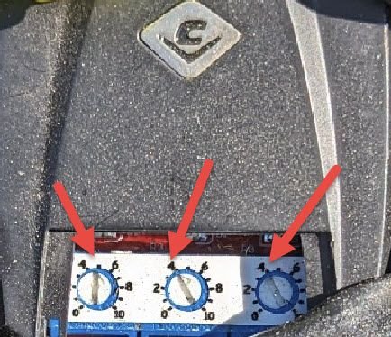

If anyone stumbles on this post in the future looking for this info (FI2000R for 96" - 2007 SG - stage 2), this is the final setting that works great:
POT 1 : 5
POT 2 : 4
POT 3 : 4
Cobra recommends:
POT 1 : 1.5
POT 2 : 2
POT 3 : 4
As you can see, its not always what the manufacturer recommends, in fact, using their "recommended settings", she ran like garbage. It took me a few months of tweaking each POT little at a time to get it right, but now its PERFECT!!!

I missed/forgot what cam you are running in your Stage II...?
I would suspect that those values change slightly depending on the cam....
Old Jul 22, 2023 | 01:39 PM
GROOVY1975's Avatar
GROOVY1975
Joined: Apr 2023
Posts: 203
Likes: 59
From: NYC
this one, 551c, I asked SS for a good cam that's reliable with HP gain and gave them all the info (SS AC, cobra EFI, drags with lollipops, etc.), and asked for a reliable cam for every day driving. I want, low end oomphhh power when I needed/wanted it (and boy does she ever), but also work with stock compression (for now) and be reliable , that's what they recommend and it's great. New heads will eventually make it's way in my twin cam.
https://www.sscycle.com/products/551...-16-big-twins/
But yes agreed, those settings are what worked for me. It was more to let others know to play around and don't necessarily go by the book.
