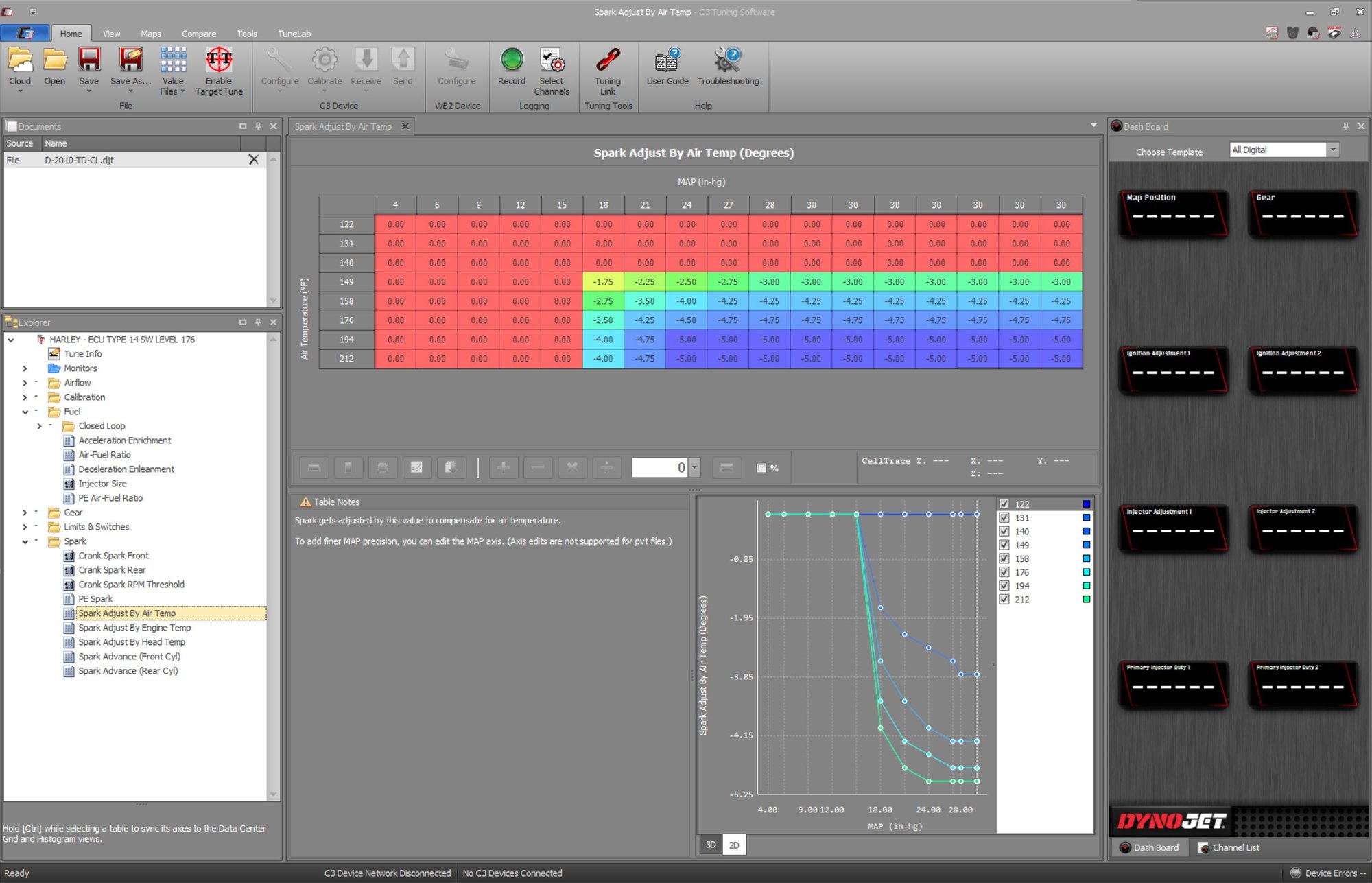

If I could ask another dumb newb EFI question (I am a carb guy), but my question is this. With the PV4 and using the Power Core software, cant I edit the fields that are in essence the same fields an "auto tuner" would provide? Meaning, I now understand and realize the differences between PV and PV4 (thanks to everyone here in this forum for helping me), now I understand the PV4 is less for on-device learning (AKA auto tune), and more of a Bluetooth flasher, with the "tuning" work performed on the PC (Power Core C3 tuning software). What I am wondering / asking is this, I am an engineer, a senior system engineer in my day job, so I tweak, and hack things all day long and love to learn / hack / ETC., so using the core software, couldnt I figure out the same results as an auto tune one (over time) and manually modify those fields in the core software, then flash it to my Super Glide and get the same results? I am asking more if the functionality is in the PV4, not how to do it. I understand without auto tune, I am crap shooting, and guessing, but couldnt I tweak the settings little by little to achieve a decent tune?
What I am worried about is the PV4 lacking parameters that say, the power vision may have, for example. I downloaded and opened the "cloud tune" Fuel Motto sent me, and from there, I can see/change "Spark Advance", this is just for example. BUT assuming I set these to different numbers, then write those params to the ECU. Can I do the same changes with the PV4 the PV would (not auto tune) just the actual parameters, or are there more available with the PV (than the PV4 has), if so, like what? I just want to make sure I am not limited to my editing power with the PV4 before I marry it to my bike (in case I decide to go another tuner). As of right now, it is still brand new, unopened, in the box (delivered today). I dont want to burn myself with having a newer product, but one that is limited with what it can do. HOWEVER, if its NOT limited, and I CAN edit the same things the Power Vision (or PV with auto tune) has with using my new PV4 (making manual changes in the software on my PC), then I am happy and will keep the PV4. But I would like 100% confirmation on this piece.
Does this make sense what I am asking, if not, I am sorry. I dont explain things very well when trying to figure something out. This is my map from FM, I am just playing around with options, and assuming it allows me to edit everything the same as a Power Vision, then no need for auto tune, but I would like confirmation before I marry it.
