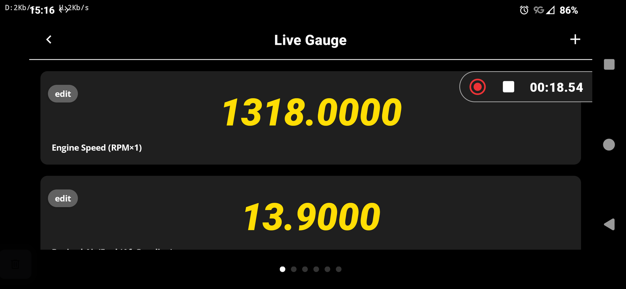

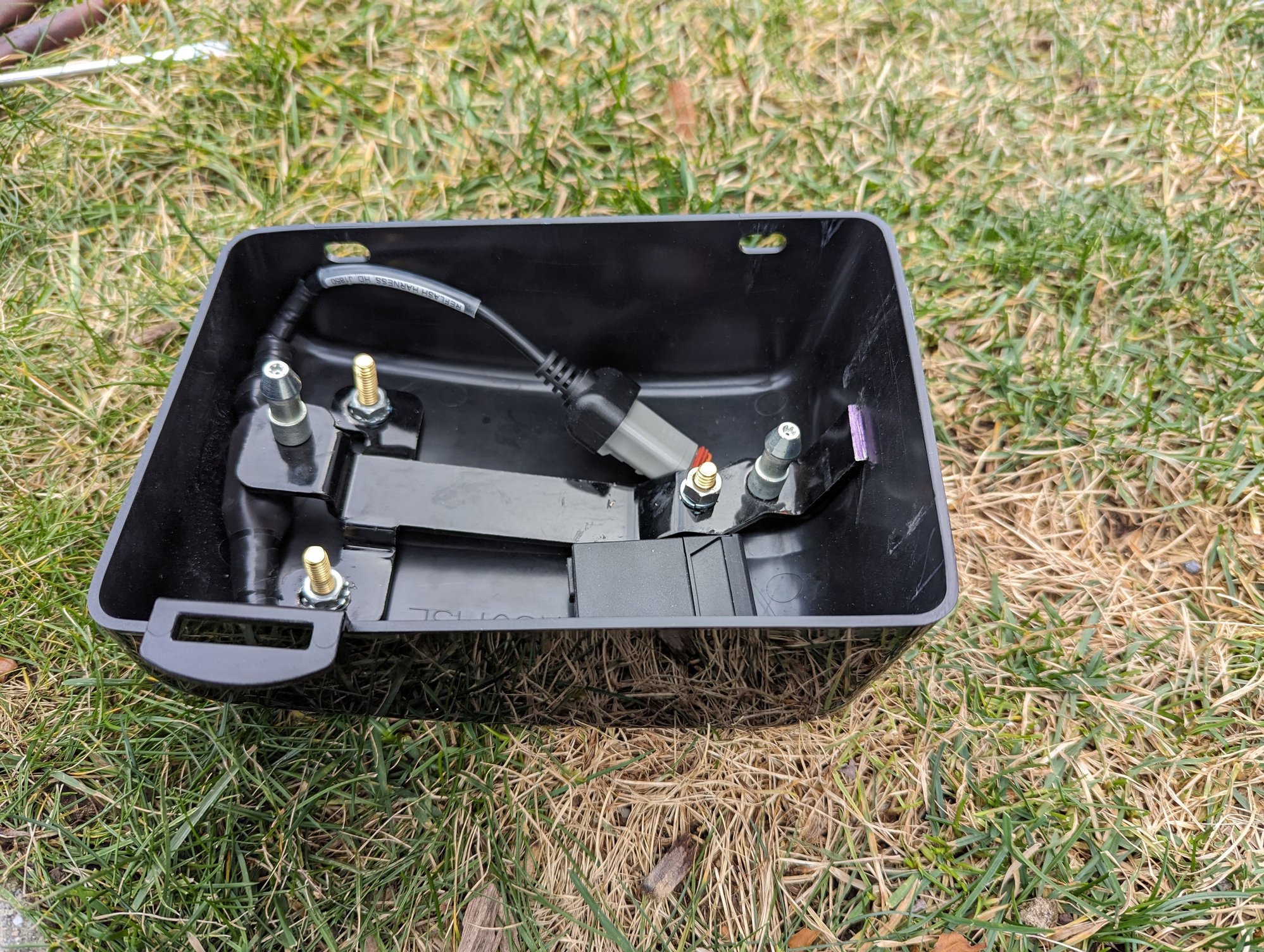

While I work with FM, I mounted the PV4 permanently in the fuse cover, connected to the diagnostic port all the time so I can log and more importantly, live monitor. I have a handlebar mount for my old Pixel 5 that is used for GPS and now monitoring live data, it's awesome:

Mounting the tuner inside the fuse cover was a great idea because it's now always on and always ready to flash a tune, or log data. Plus I am using my old Pixel 5 permanently mounted to my bars for GPS and live monitoring so I'm REALLY happy with my PV4 so far! Sure, as others pointed out, it lacks auotoune and things like it (for now) but with the software and PV4, I'm able to manually modify almost every aspect and detail of my ECM and config so what else would I ever need in a tuner! With the software (power core), and my tune saved to the cloud/phone, I can edit it all day long until it's perfect then test drive and save the info to help others!
