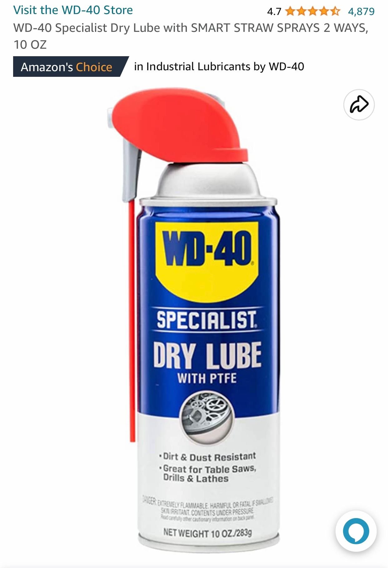

I use this on my ignition and fork lock and around the house on door handles, hinges and anywhere a key goes. Haven’t used it on bike cables but now thinking I’ll give it a try. Impressed on how it works on everything else.
