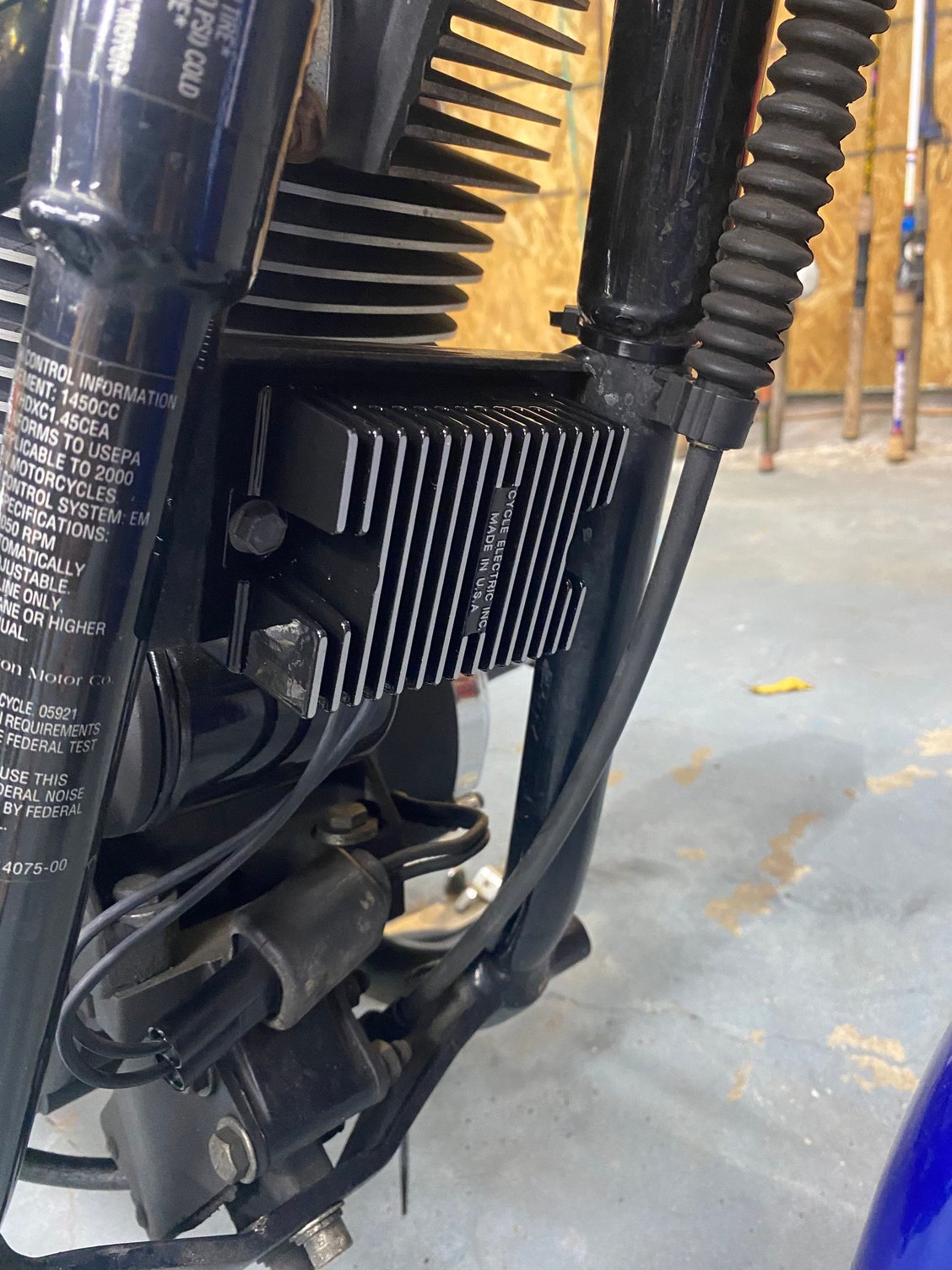

Just fired it up and put my meter on the battery. 17.2V at a high idle choke pulled cold start. I think that may have something to do with it.

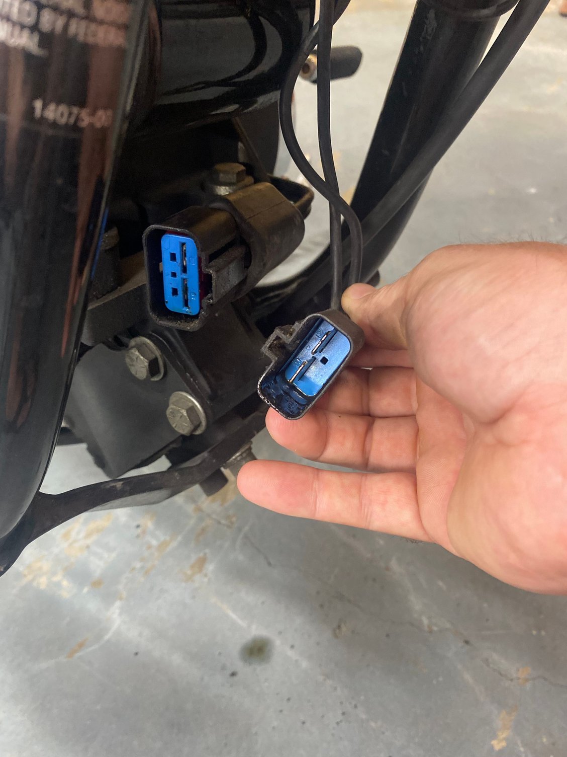

The stator checks out as good with resistance within parameters and no continuity.
However, there was oil? in my plug.
I don't know how that would happen but I'm guessing I'll go with just a regulator and see if that solves it.

I put the new regulator on and she's ready to ride again.

Originally Posted by TXFXR
Update:
Look right above that plug.......
Looks like someone got sloppy with oil filter changes....

While the oil could be oil from an oil change but with the age of the bike and if the stator is original, it could simple be from oil leaking down the wires from alternator. My 2000 FXDX did that. You find more oil inside the connector than out.. I replaced my stator when the center of the rotor blew out somewhere around 50000 miles..
It sure could be and most likely from the previous owner, I've only changed the oil once after I built the motor and didn't lose a drop haha.
Yeah that was surely the case. I sprayed a lot of electrical cleaner in the plug and shoved some dielectric grease in there to be sure everything was good. So far everything still seems to work fine.
