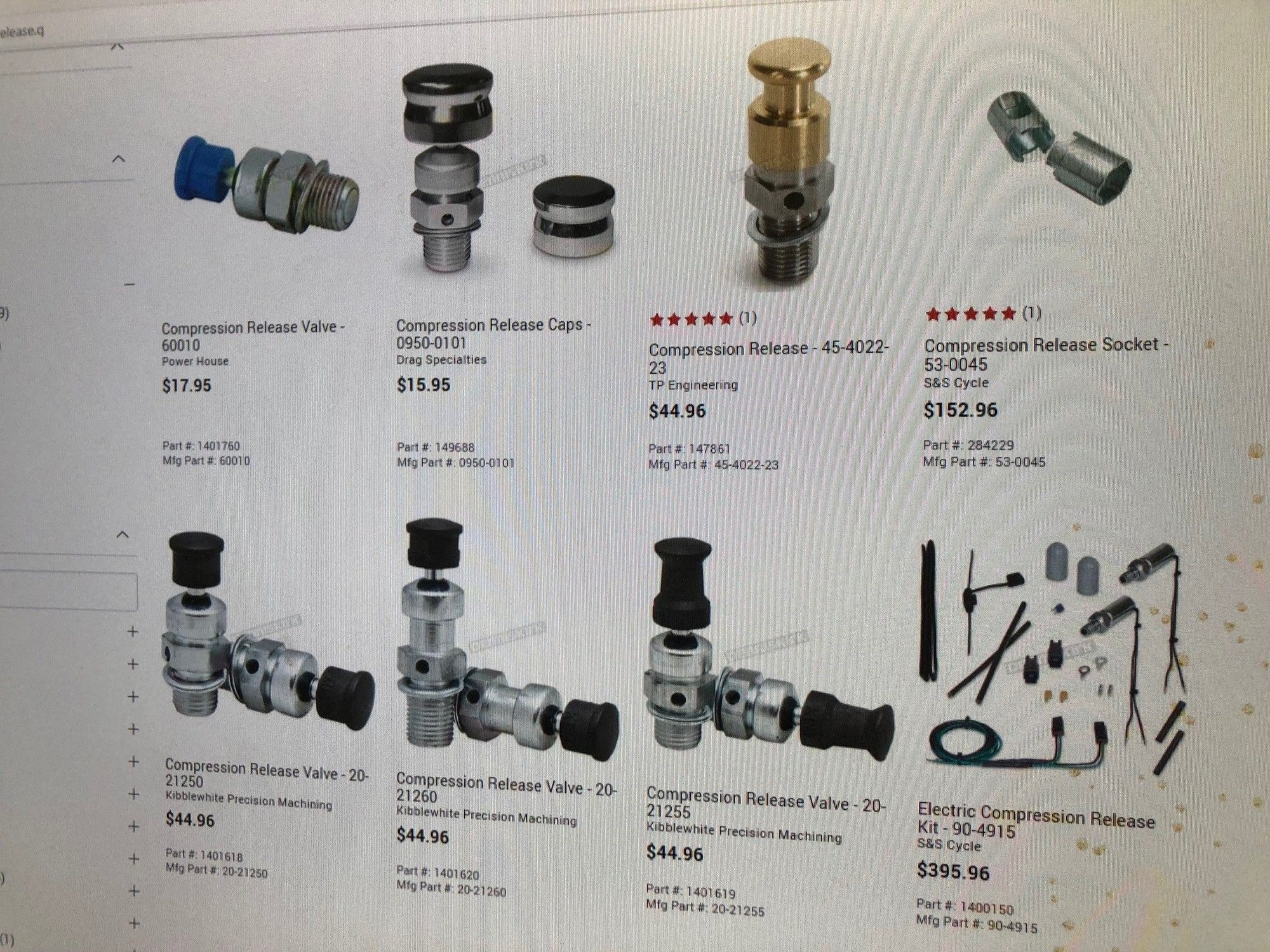

Greetings to everyone, thank you very much for your warm welcome.
I have reached a lot of useful information in the forum and thanks to you I have gained knowledge, but now I have a big problem.
I have a 2008 Dyna street bob 96 cubic and as most of you know, it has a chronic problem. As far as I have heard, HD in many European countries has collected these models and introduced new models to users.
There is no this application in Turkey and it is said that the ACR kit should be installed on the engines, there is no problem when the engine is cold, it works on a single starter.
When this work gets hot, it starts to get strange and the engine starts to not start, it throws smoke from the engine and throws the pressure inside.
For this, it was said that an ACR valve should be installed, the prices in Turkey are very high.
My brother is now in NY, is there someone we can buy or supply this part?
Please correct me if I am wrong, I read the forum rules, but I did not know if it is forbidden to share a link or suggest an address related to the purchase and sale of parts.
Excuse my English, I am writing as much as I can learn

Would be simpler and cheaper to install MANUAL compression releases
Your brother could source them from Dennis Kirk / J& P Cycle or Summit racing and ship to you
Thank you for your help but which one should i choose did you know something about that ?
Thanks again.

If it's a stock motor I think that there is another problem. It shouldn't need any compression releases. I don't have any suggestions but maybe some of the smart people here will be able to help. (No offense, eighteight, it's a better idea than the ACR)
