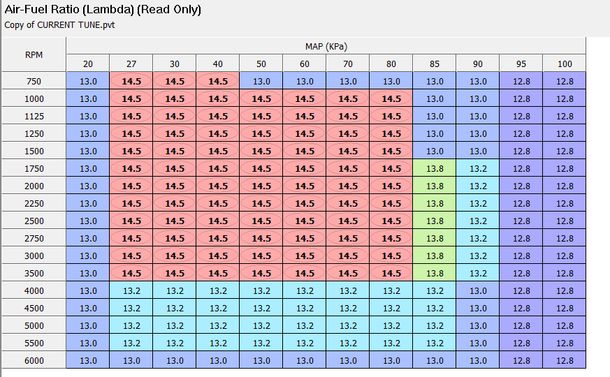

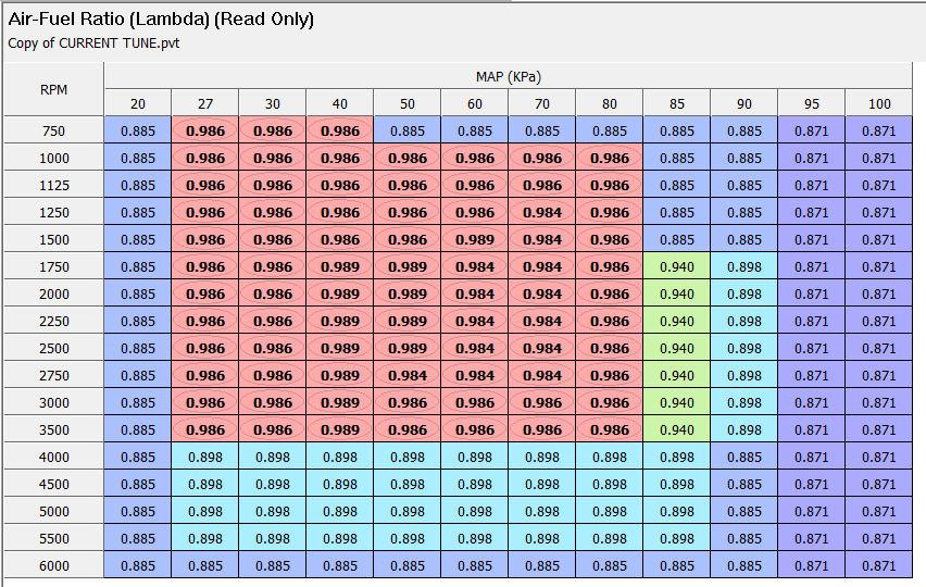

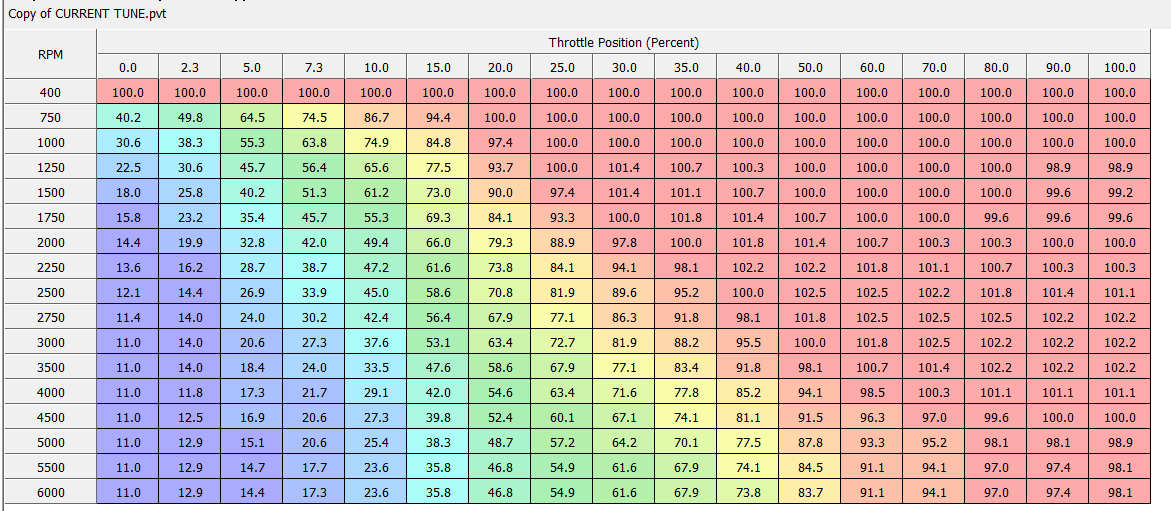

Can you tell me anything based on this? I keep looking for the maps you guys use from your dyno but this is all I could pull off the PV. I worked from the canned tune and settled on this after about 10 rides, but didn't like the last few edits and stayed with the 7th or 8th. There's also a 3D model that looks like a tabletop mountain in rainbow colors but I wouldn't know how to go about importin that image since it moves.

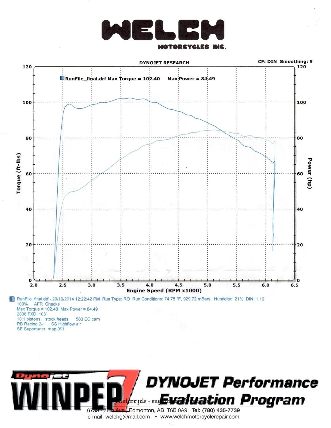

81 /103 is certainly respectable but FM shows 94/111 with a 570 / 2
Wonder where the difference lies ?
Dyno Happiness?

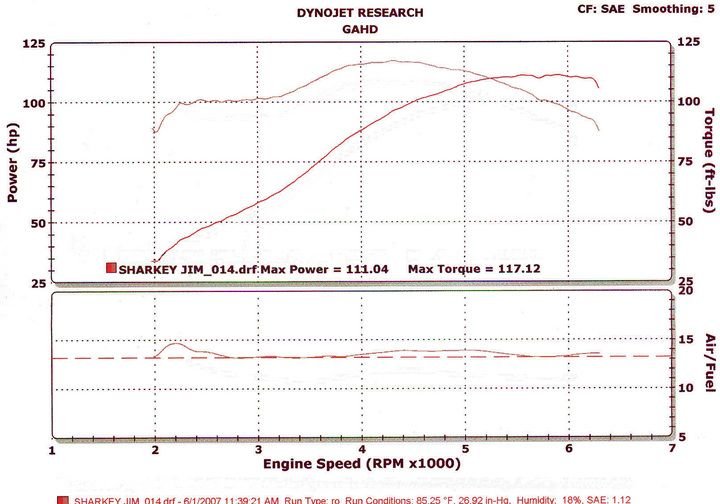

Two 103's of mine; I still have the second, lower power one. It's EFI and much more suitable for touring. I also really enjoy the S&S E-Z start cams...stock starting system and never any problems, even on hot summer days. Choose careful. Fuel Moto is a good start. I have other resources where I live way up north.
