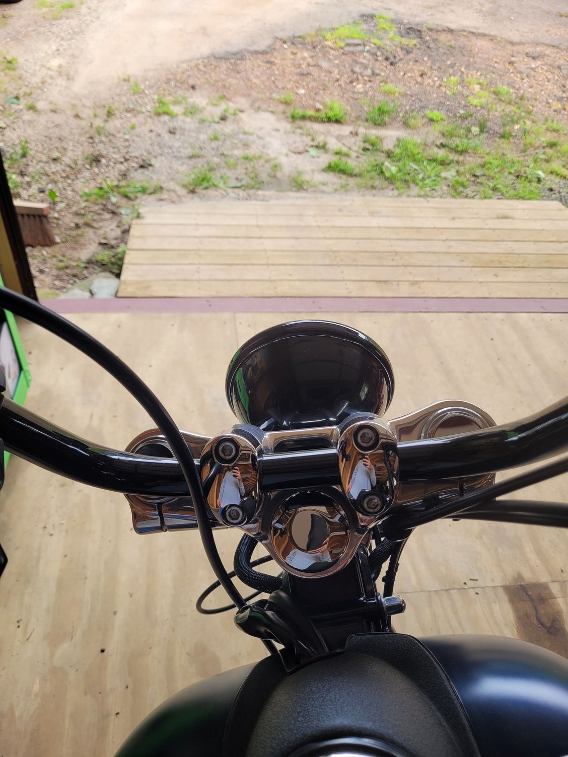

I am starting to plan my winter projects, and want to relocate my gauge and add a tach(dual gauge setup) to my handlebars. I am having a hard time finding a bracket that will line up to the hole pattern of my triple tree. I am running stock mini apes. Was wondering if anyone knew of a bracket for this application.

Unless I'm mistaken, a 2009 FXDB has the risers built into the top tree. Ya need to use a top tree with removable risers to get the right spacing to mount the gauges.

I would look around for a clean top tree off of an 13-up Street Bob or Super Glide so you can use bolt on risers. Once you've done that there are a plethora of options for gauge relocation, and ( in my opinion ) it just looks cleaner.
