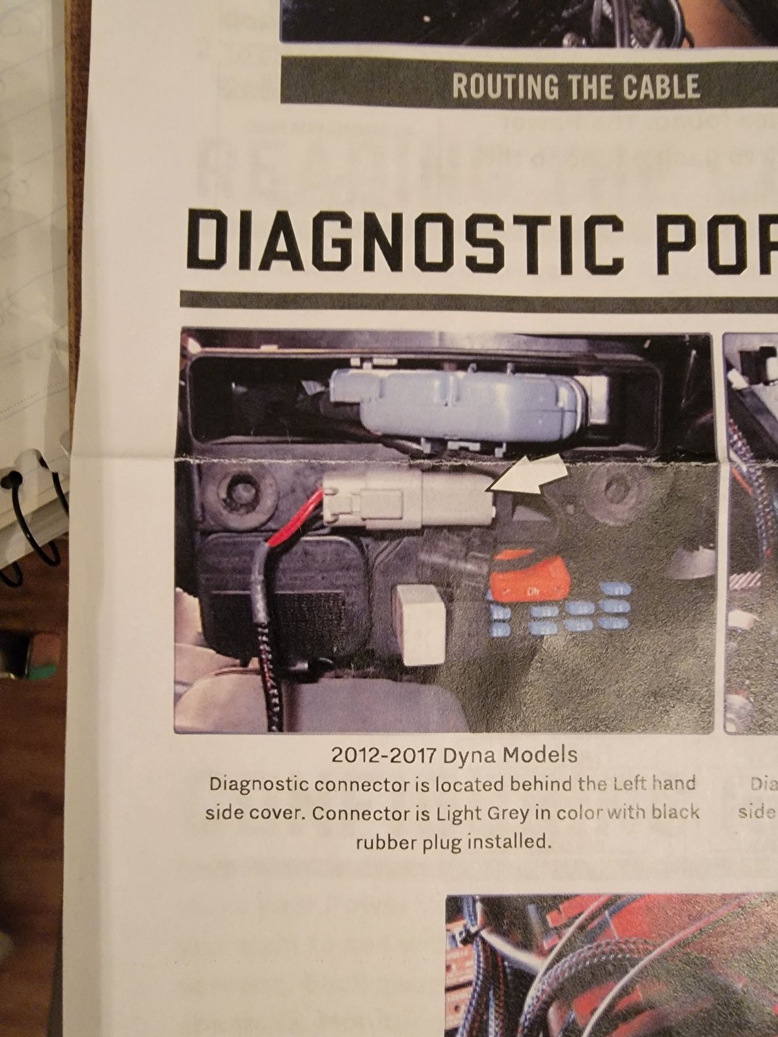

Yes we are looking for the gray colored plug that should be under the left side cover and it's not there. The storage location is there but not the Plug. Not being a wise guy but I know what the plug looks like as I've flashed my 16SGS and 20RKS both of which have their plugs stored under the left side cover and are identical in looks to the Dyna plug. It's really crazy we can't find it as the wiring harness would not allow it to go far but even the wires are not there. The pic in the Dynojet directions show the wires coming up from the bottom of the bike.

So I went back to the Dynojet instructions and they state 2012-2017 Dyna models are under the left side cover. His bike is a 2010 could it be somewhere else maybe?

I don't think that picture looks like my '14.
That's strange yours might be different. This picture is exactly what we are seeing under his left cover but where the gray plug with red wires is we only see the little slide in storage area. I'm sorry I didn't mean to sound like an *** about our skill level, I'm just frustrated right now. This is his first Harley coming from the Import bike world and not only could we not find his plug to flash the bike. I ended up finding his inner shift shaft lever is stripping the transmission shaft because I guess the original owner never put a allen wrench on the lever bolt in 6k miles. The shift linkage has so much slop in it and when I inspected the lever and shaft behind the inner primary I was amazed it was even changing gears.

I'm realizing now in the Dynojet pic the plug with the red wire is from the PV3 and the wires for the bike plug should be coming from the inside of the mounting bracket holding the main fuse and other fuses.
