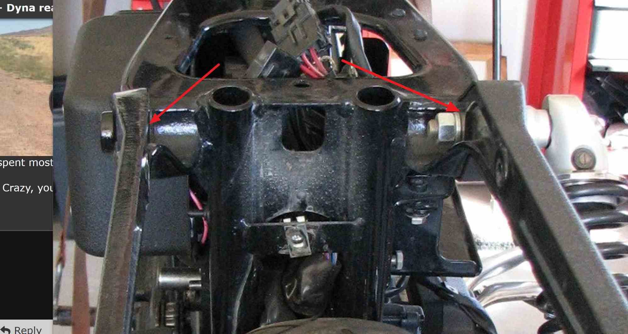

You're right, the 2006 and up fender is wider. If the newer fender comes off a 2008 and up Fatbob or a 2010 and up Wideglide, the fender is even wider than the rest of the 2006 and up Dynas. The fender struts aren't bolt-on, they're part of the frame. Cutting and welding is required, whether widening the distance between the struts, or narrowing the fender.

You don't have to cut and weld but you need a oxyacetylene torch with rosebud or cutting tip to heat the fender brackets up and straighten out the bend some.. You'll need to respace the rear top shock mount if using the stock fender brace covers.

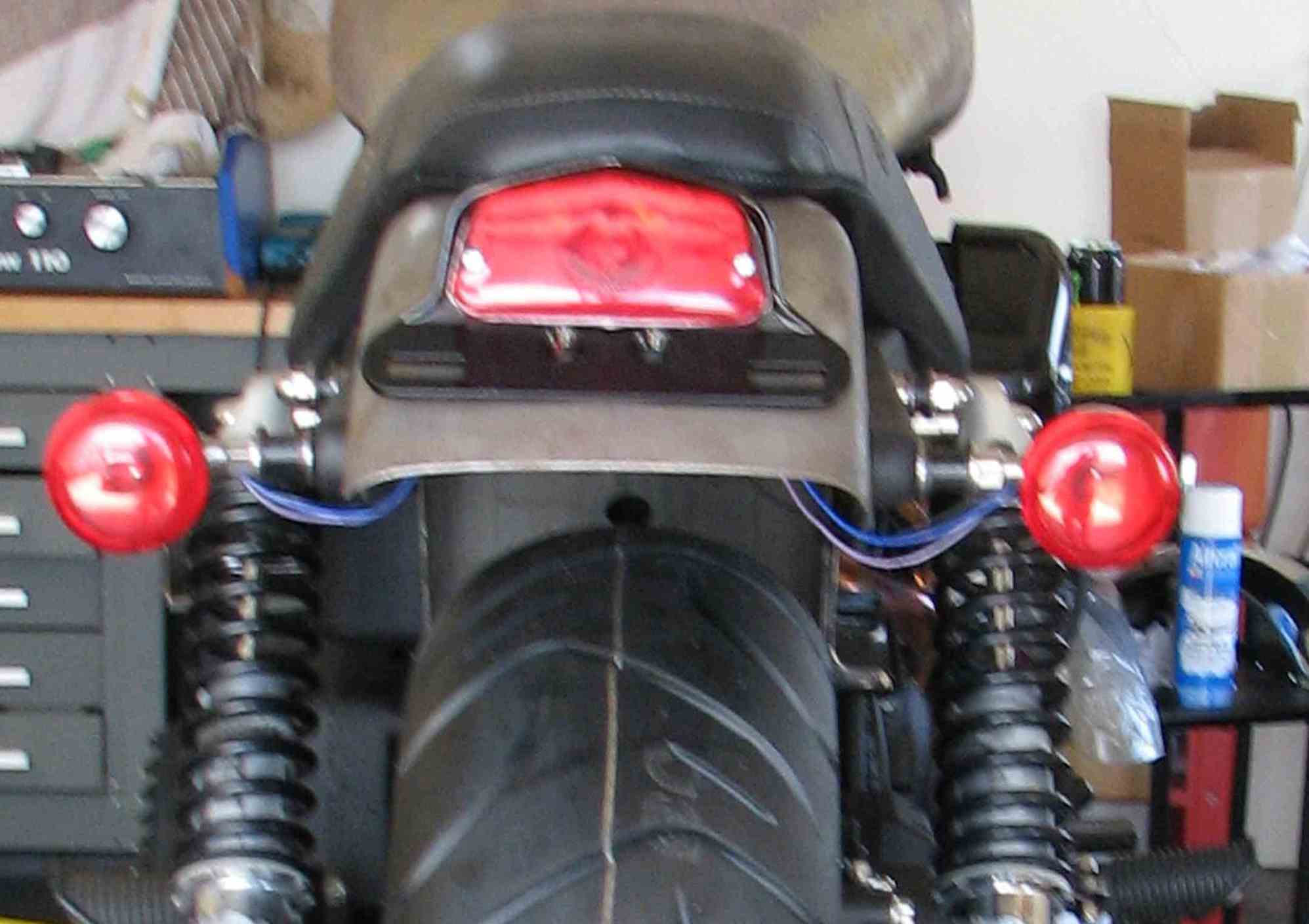

I don't remember the exact amount, I simply put a stock fender strut cover on after bending the brackets out.. You'll need to shorten the outside spacer some and add a spacer inside. One thing to note is that I didn't use a later fender. I used a 7 1/2 inch fender from Drag. It ended up being about 7.7" wide with paint. You might want to check to see how wide the later fenders are.. I did manage to fit a 180/55x18. Did all this stuff 15 years ago..

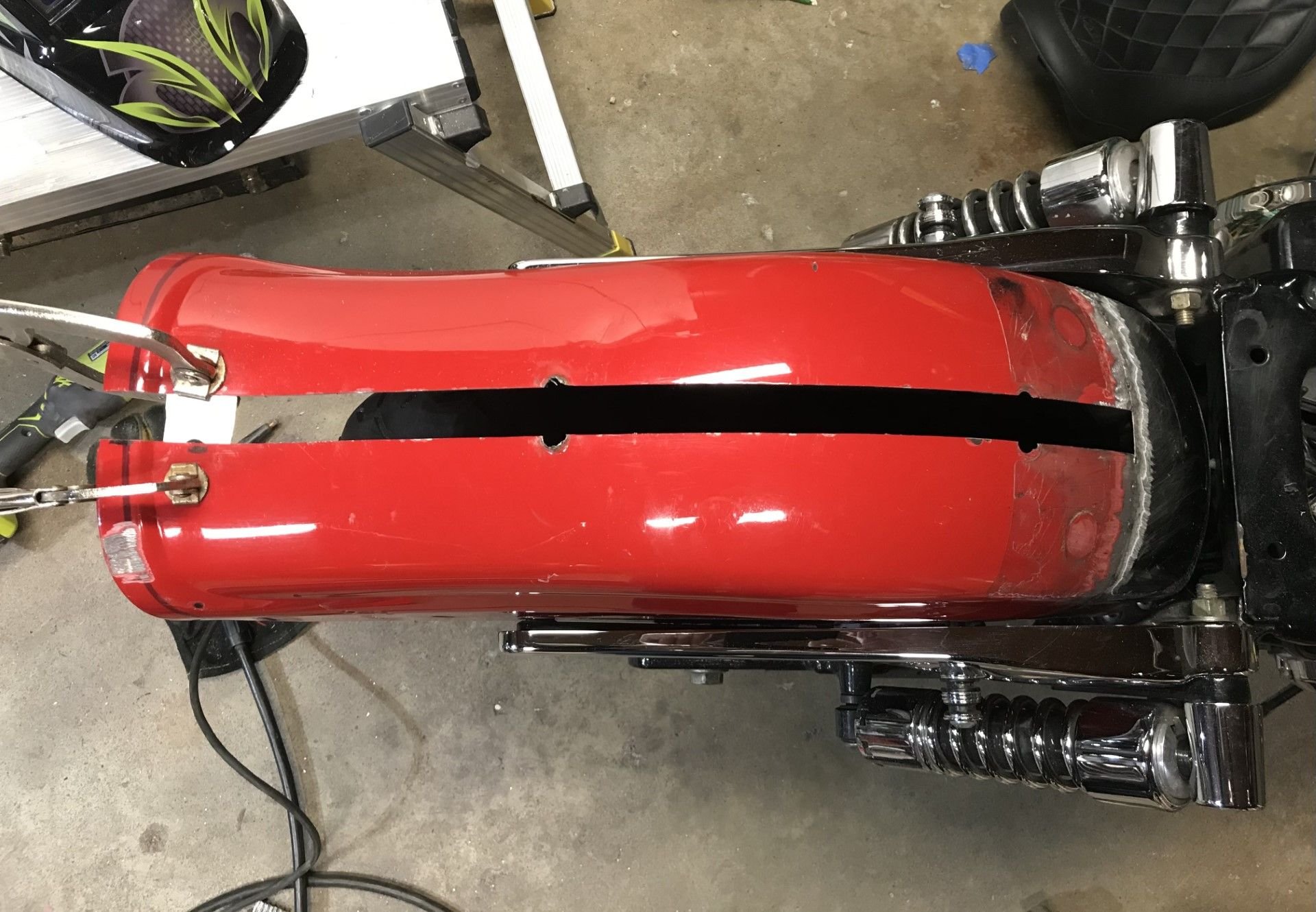

I went the opposite direction and made an '02 fender fit my '09. This photo might help you get an idea of the width difference between the early and late Dyna fenders. The black section between the shock bolts is my original Super Glide fender, the red part is off an '02 Wide Glide.
