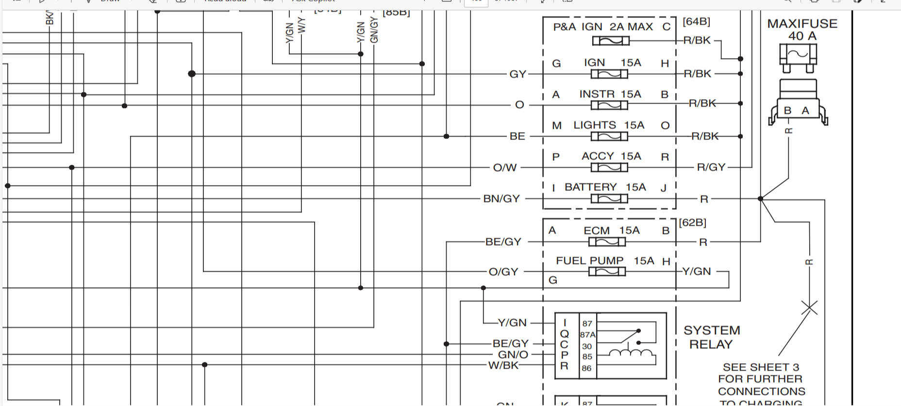

For giggles and grins, I checked my service manual and owner's manual (2002 FXD) and the fuse labeled J-I is for accessories. Mainly for TSSM, if you have it and the turn signals. check the turn signal sockets for corrosion that maybe providing a path for power. Also check the TSSM unit for corroded plugs. Just another idea.

2004 Dyna J1 is Battery.

Yeah, I was wrong about the BAT fuse powering the ECM..

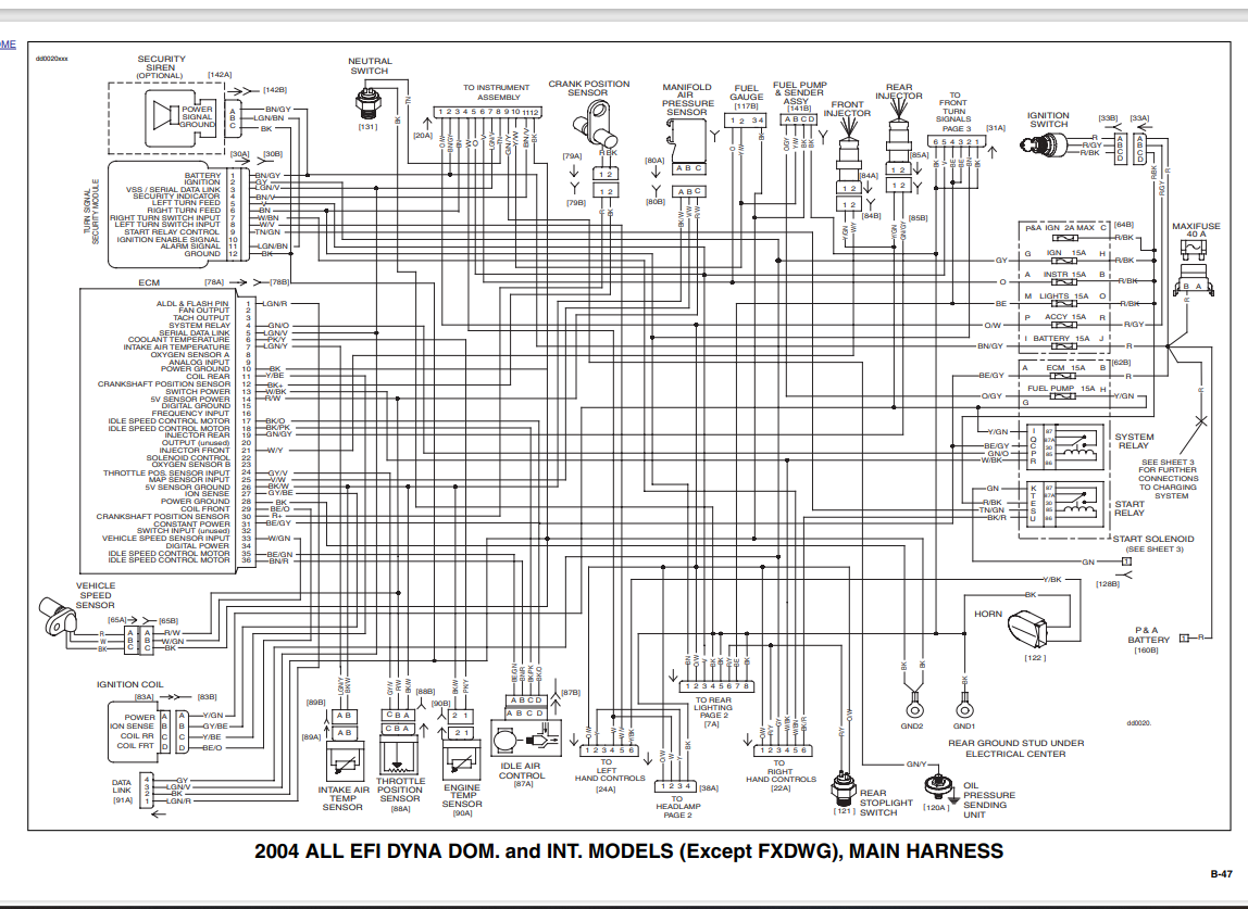

The only things that fuse feeds, according to the schematic, are the TSSM, the alarm siren, and something in the instrument assembly. Unplug them, one at a time, until you find the problem.
Old Feb 27, 2024 | 06:33 PM
Max Headflow's Avatar
Max Headflow
Joined: Dec 2005
Posts: 19,893
Likes: 8,001
From: poway
It's the speedometer. You can get current mileage by pressing the trip button with the key off.
