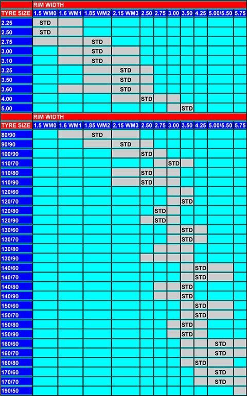

Odd question I have a 90/90-19 front tire that's new . Will it work on a 09 Lowrider that has a 100/90-19 on it now . I know you can go up in size but wasn't sure you could go smaller .

Almost definitely, that rim is 2.5" wide AFAIK and that is the max rim width recommended for 90/90 tires by many tire makers but it would be a good idea to double check at the specific tire makers website.
The diagram below from the web was compiled (not by me) from info from various tire manufacturers.

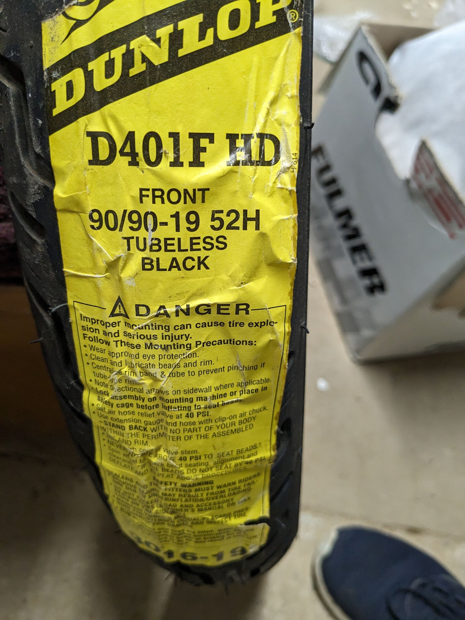

This is the tire

What's the Date Code on that tire?

It says 3522 doesn't that mean 35th week of 22 ? I decided to just buy one the size it has on it .

It's within the recommended size range for your 19x2.5" rim. It has a slightly lower load range rating than spec for bike, but should probably be ok
