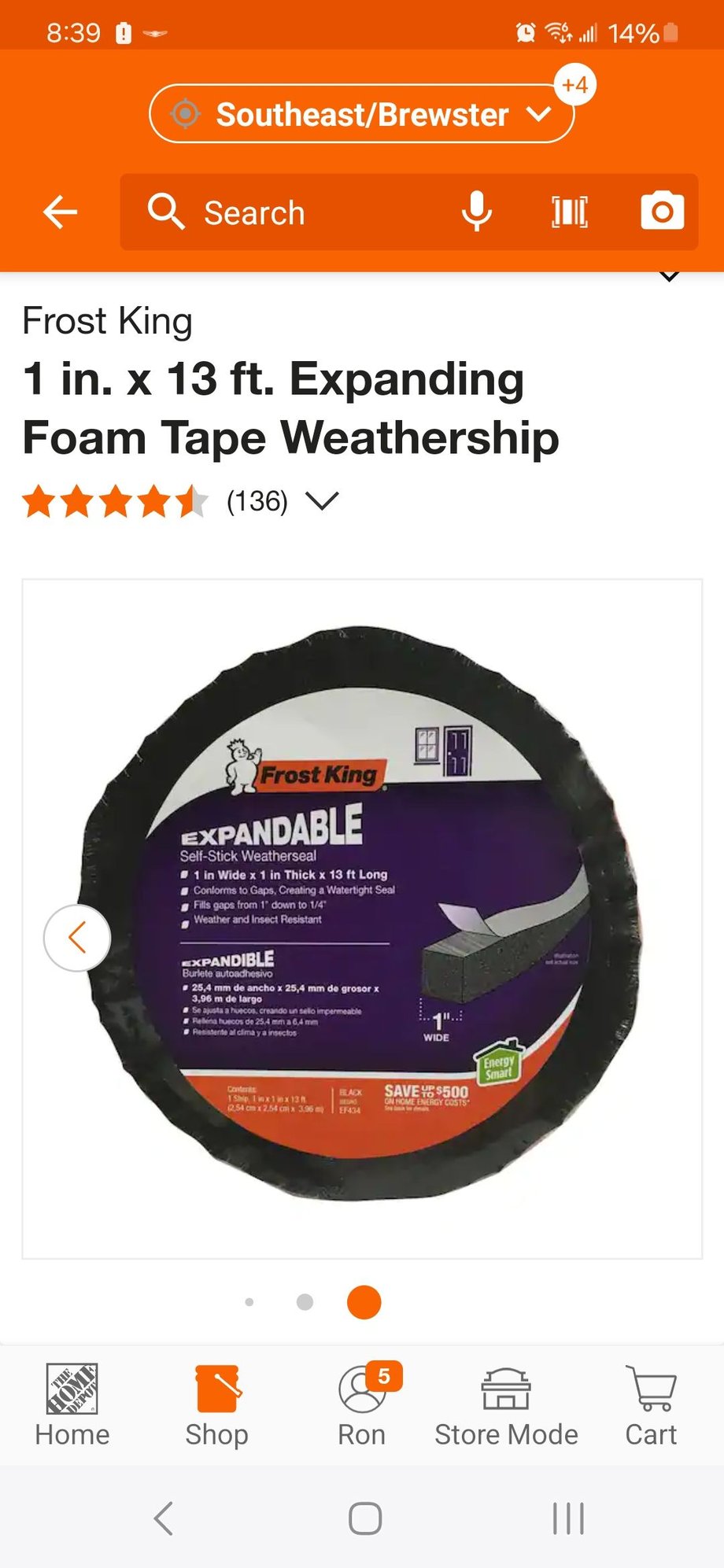

Home Depot has a black spongy dense type weather seal material that's self adhesive on one side. There's different sizes but you could get it where it starts out at a quarter of an inch but expands to an inch once put in place so it will fill the gap totally. I use it in air conditioning vents to seal around zone registers. Works great.
Lowes has it too..
https://www.lowes.com/pd/Frost-King-13-ft-x-1-in-Black-Foam-Door-Weatherstrip/1001098994?cm_mmc=shp-_-c-_-prd-_-hdw-_-ggl-_-CRP_SHP_LIA_HDW_Online_E-F-_-1001098994-_-local-_-0-_-0&gad_source=1&gclid=Cj0KCQjwztOwBhD7ARIsAPDKnkBMf wDzu8wVFZGQIXwNHSIswn_aMgXhovqlrkvbyjo3eqIoh9NrnrM aAjcLEALw_wcB&gclsrc=aw.ds
