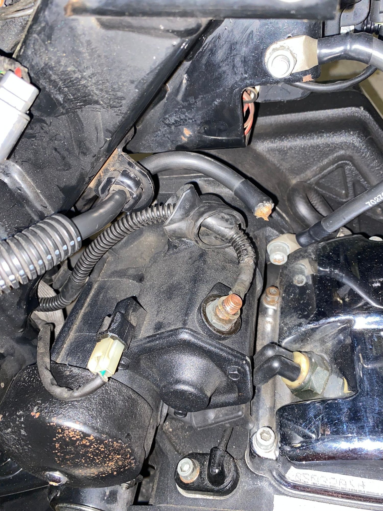

Hey mate, I’ve had heaps of electrical issues with my 88”. It’s an 02. Before replacing anything, check all your grounds AND the positive cable from your starter solenoid to battery terminal (the big 4awg cable). Mine was holding on literally by 4 strands and causing heaps of issues. Unfortunately I only noticed after replacing stator, regulator, battery, relay etc.
This cable
