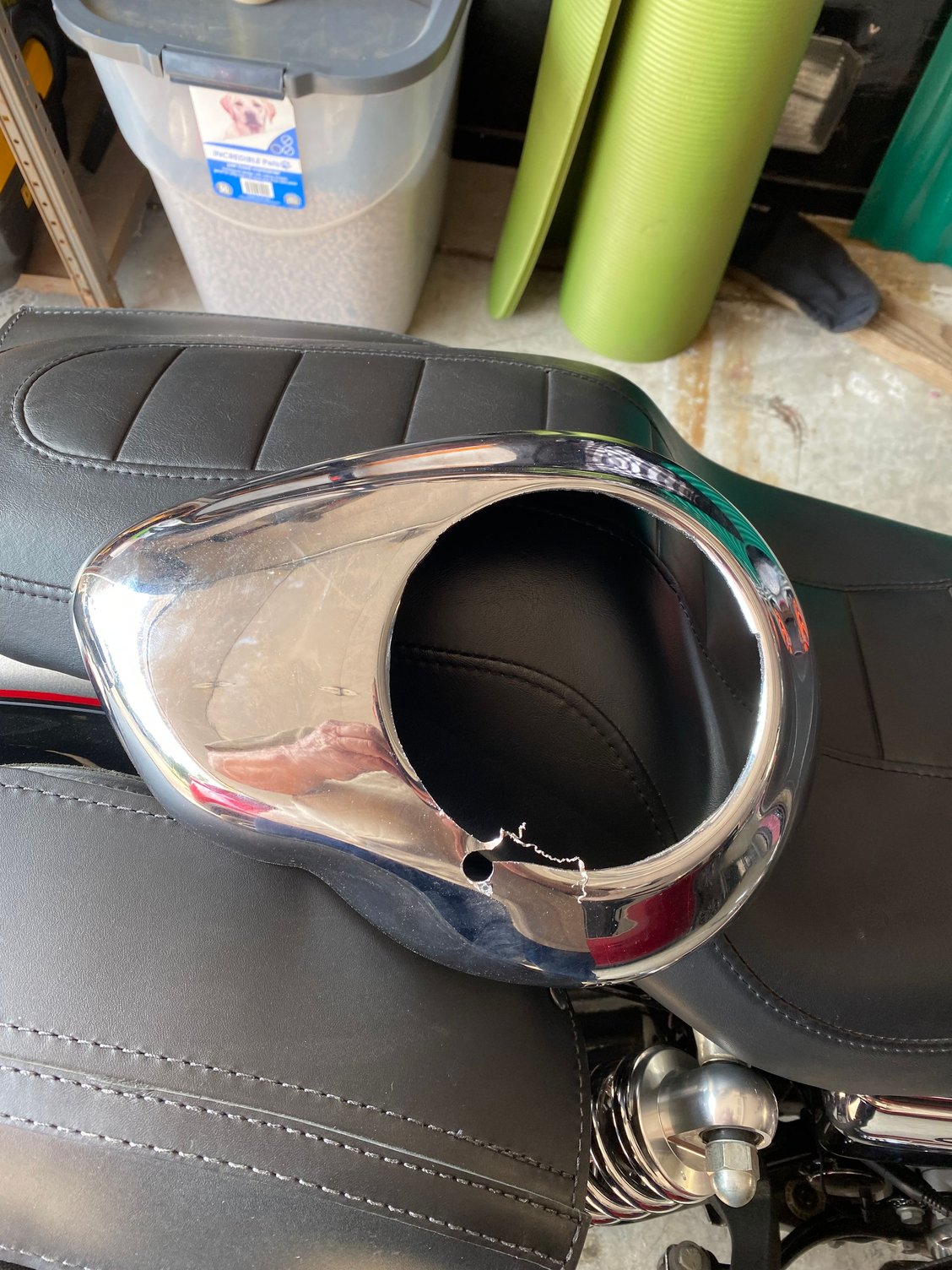

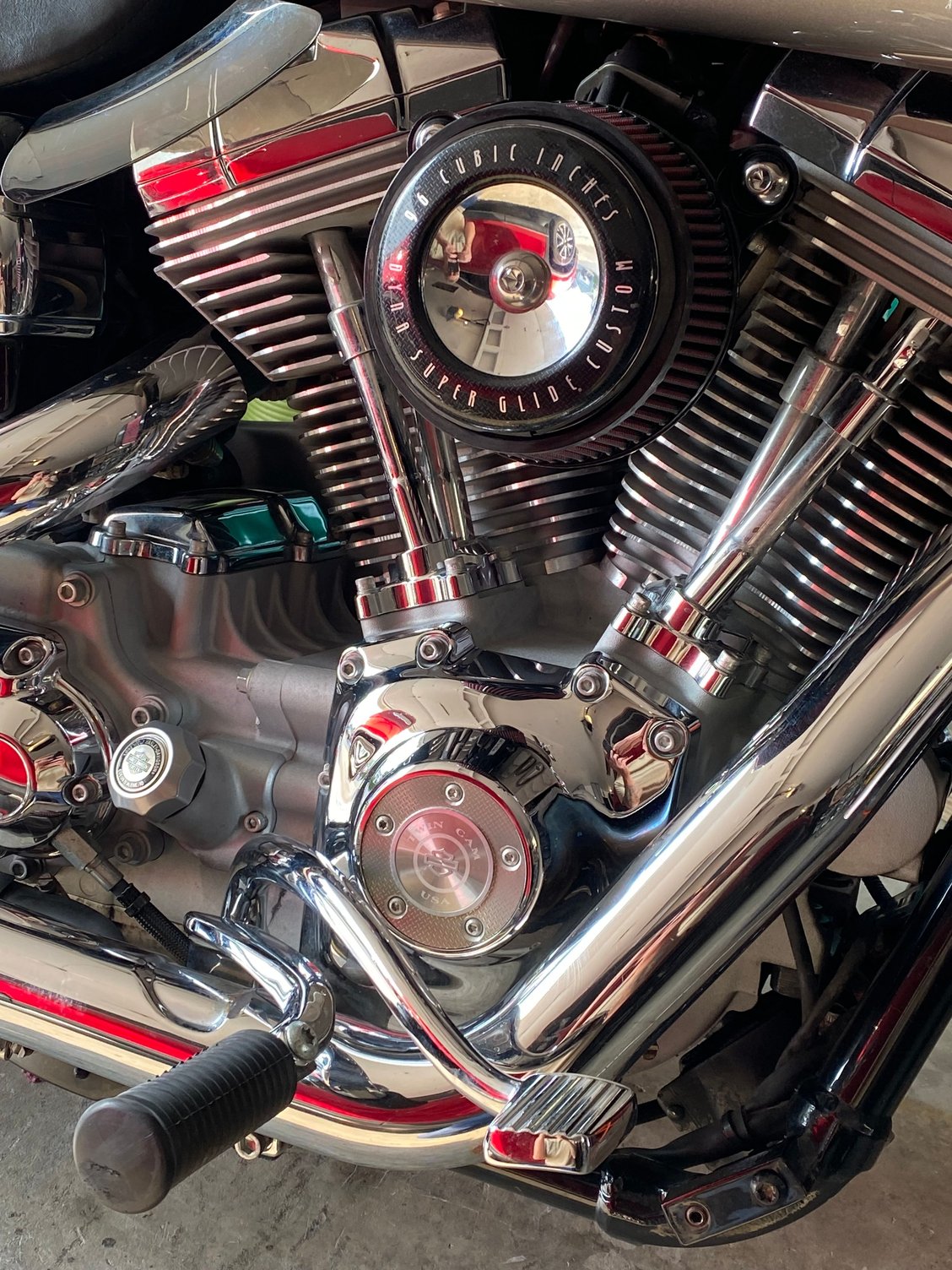

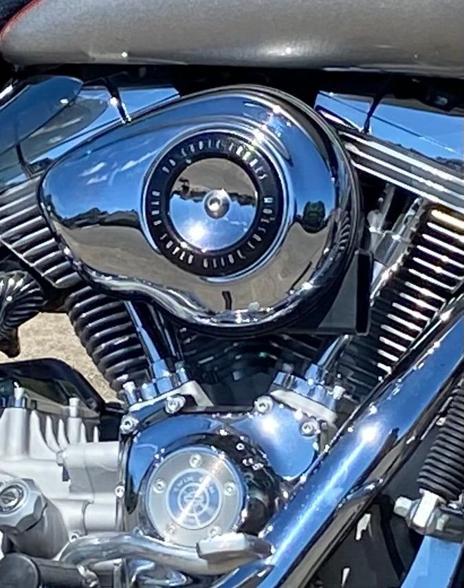

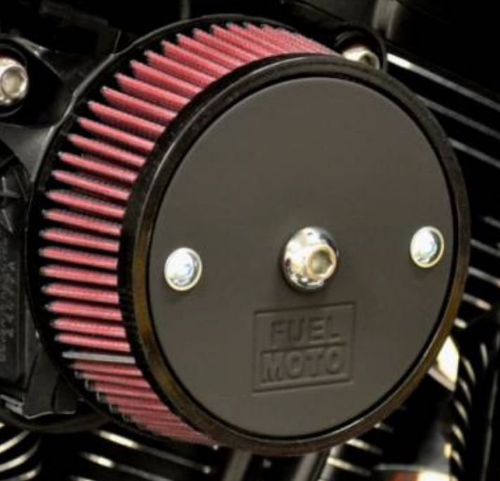

Default Fuel moto AC/DC cover mod
No I didn’t use a Dirty Deeds Done Dirt Cheap cd as an air cleaner cover, FM calls their air cleaner AC/DC. The kit provides a plain black cover with the fuel moto logo stamped in it. The mod is self explanatory below in pictures. The stock Harley A/C cover gasket was cut to size to fill a ź” gap around the circumference of the cut piece. The center bolt runs through to the fuel moto cover, so it’s air tight. Cut with a jigsaw and smoothed out on a table grinder.

super easy and quick, 15 min. ˝ the time was fitting the gasket and shaping it to the circle.
