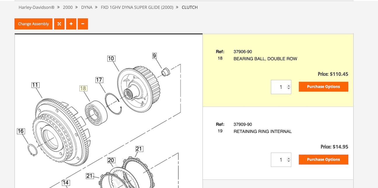

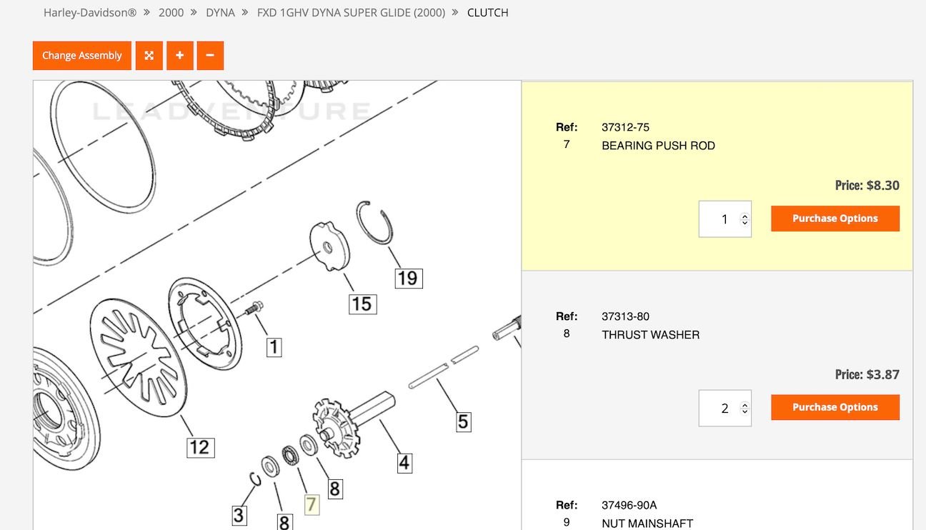

You need the pushrod baring, or the clutch basket/clutch hub bearing?
They are most likely all the same for a given model family for that year, but if you post your VIN, we can tell you what the bike is...
The first pic is probably what you would need for a Dyna model pushrod bearing. It's #7, and has been used since 1975... Part #37312-75, or an aftermarket equivalent, but your dealer should have one.
FWIW... my 2016 Low Rider uses the same pushrod bearing...
The second pic is the info for the #19 clutch basket/clutch hub bearing #37906-90... My 2016 Low Rider uses an updated version of that bearing, updated in 2011.
