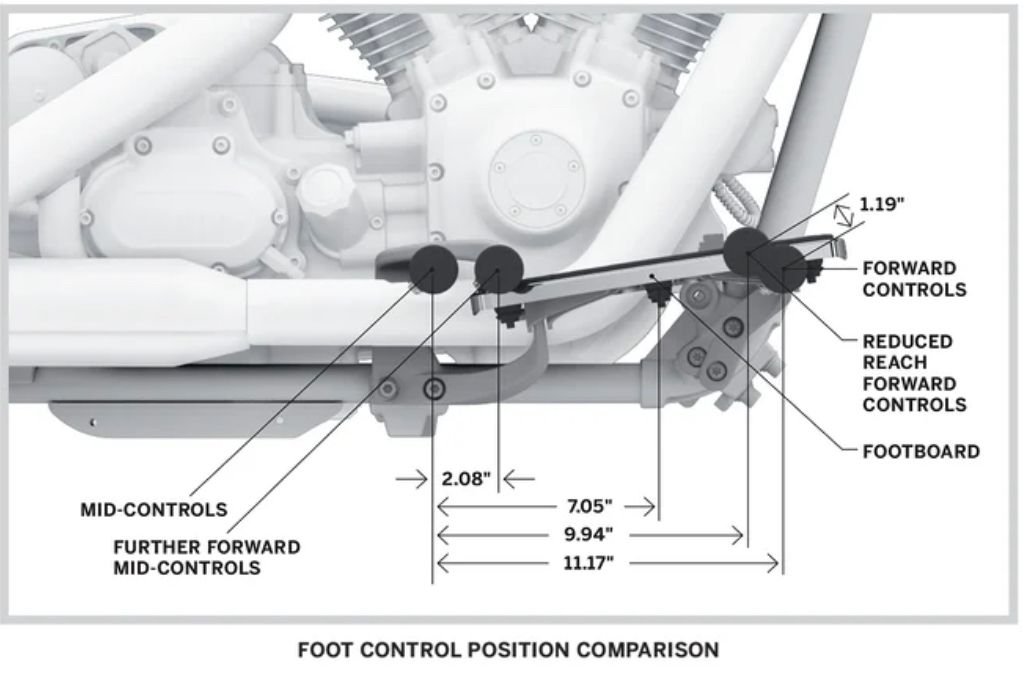

Again, not aftermarket (which tend to be cheaper), The MoCo makes 5 different sets of foot controls:
Mid-Controls
Further Forward Mid-Controls
Footboards
Reduced Reach Forward Controls
Standard Forward Controls
Here is a pic showing the relationship between the various foot controls and how they relate to each other
ftwflh
