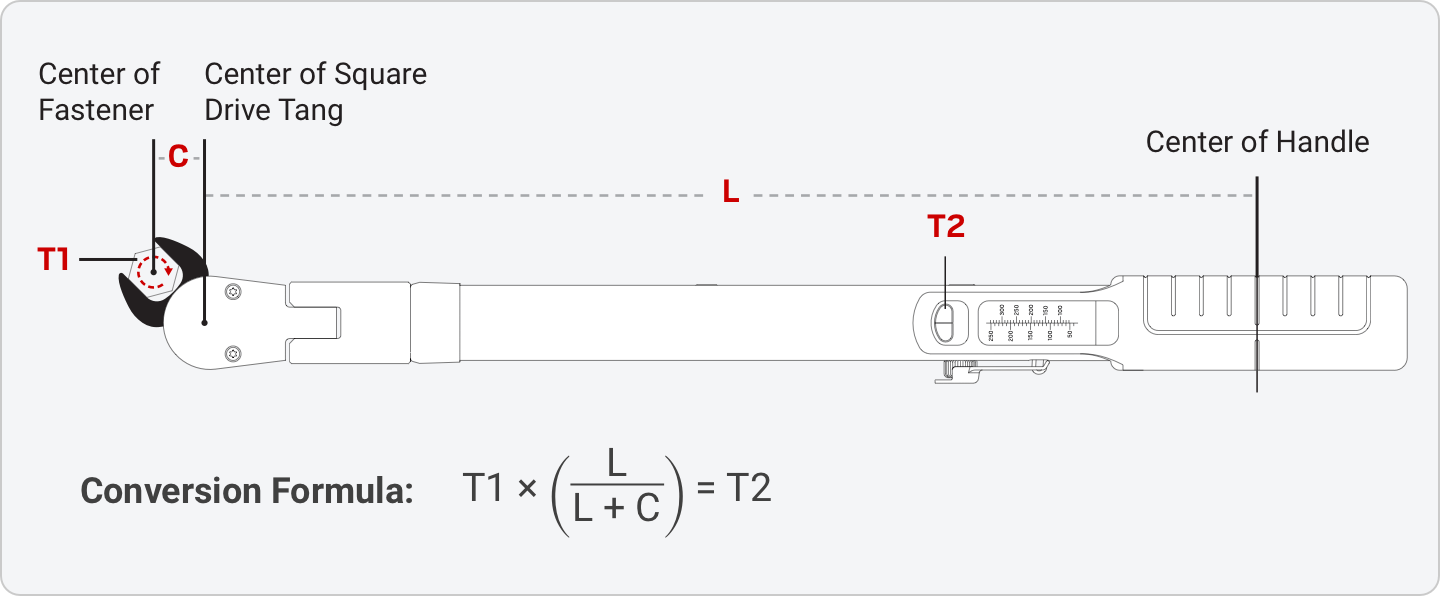

I am getting ready to replace my rocket box bolts with ARP polished SS. What is the trick to torque them with the engine in the bike?

I have always used a dog bone adapter for the torque wrench on those bolts.

Got one of these........I always stay low on the torque value to not break off that little nub.
Feels like it could snap off.

If you're using any type adapter on a torque wrench make sure it's at 90⁰. It won't change the torque that way.
True , but if that isn't possible there are ways to calculate the correction.

I appreciate all the info. I ordered a torque adapter and found an app to calculate torque setting with the offset.

I have a complete set of Snap On Torque Adapters, but there are at least 2 spots where there was no way they would work.
I just used a S shaped box end wrench and estimated...
I know you already ordered one but down the road if your handy with a welder or have a friend that is, make yourself an extension. You can pick up wrench bit adapters from Harbor Freight cheap or you can cut up a universal joint adapter.
The nice thing with the homemade extension is the ability to be able to use it on multiple size bolts. I can post a picture of the one I made as an example if you'd like.
