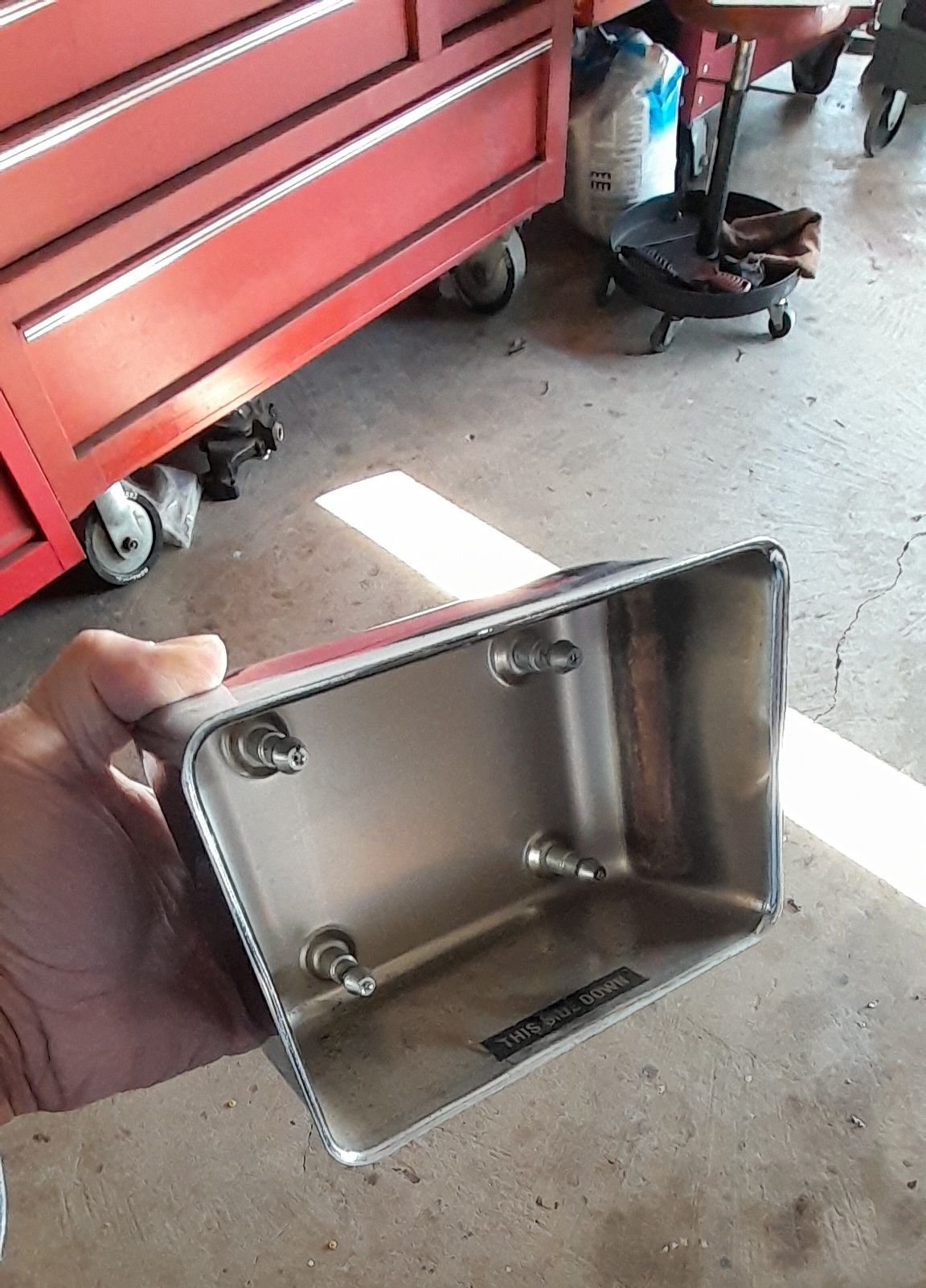

The electric panel cover PULLS OFF. Those torx head bolts hold the fuse panel in.

Dyna fusebox cover. It pulls off but it sure screws with people (no pun intended) with those two bolts on the side. Ask me how I know

Depends on the year...97 are 4 bolts on the side of the cover. No bolts on top.

Similar to my 2000 FXDWG. Underneath mine is 4 nuts that hold the "Cover mount Plate". That gives me access to the TSM, relays, and what I think is a diagnostic port.
Just pull the Cover off.
Quick access to TSM, relays, and diagnostic port.
Remove the 4 nuts for access to TSM, relays, and diagnostic port.
Pulls off of 4 grommets
