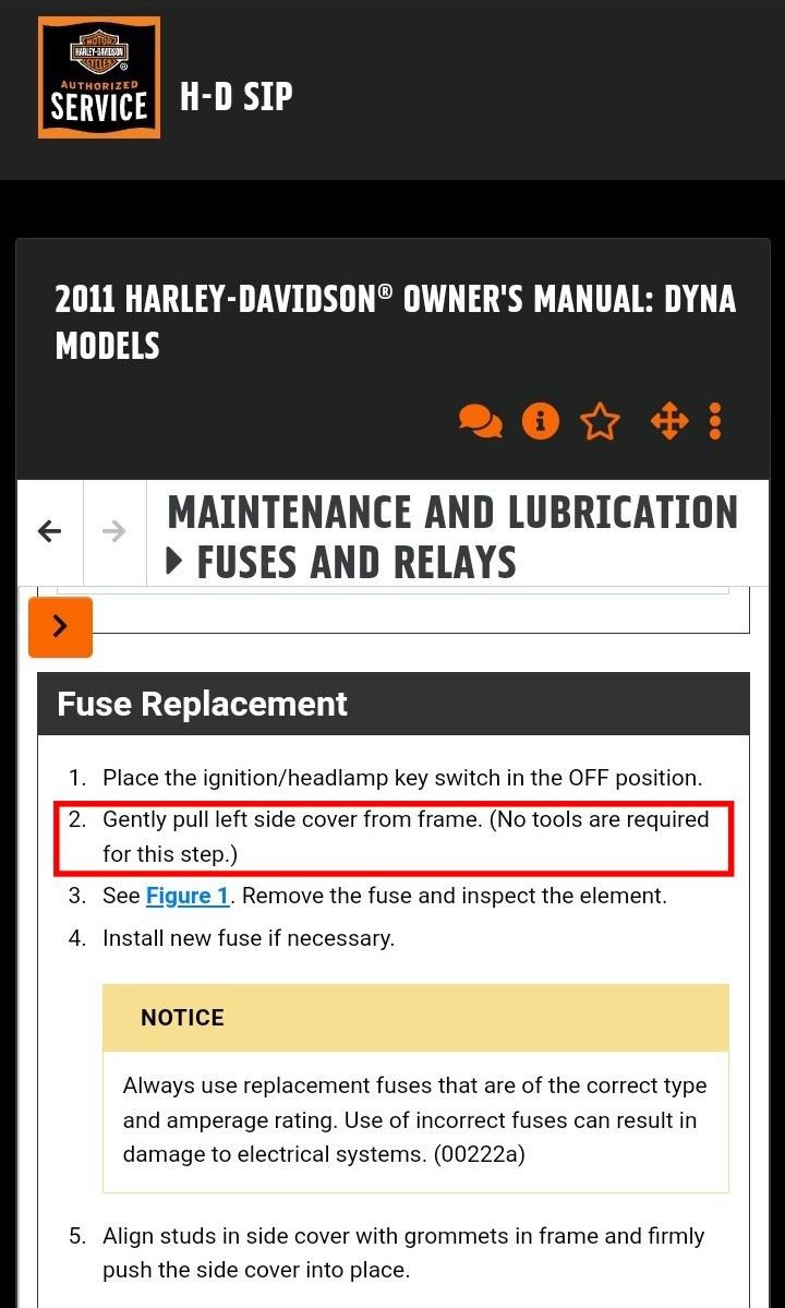

Here's a link to the H-D SIP site.
https://serviceinfo.harley-davidson....&timeout=false

Originally Posted by barneyboy
As you wish. It doesn't hurt to read the Owner's Manual before opening the tool box.
I wish, i bought this Wide Glide with one FOB and no owners manual.
The original owner is my SIL...i dont think he knows where the stuff is.
I don't have a hard copy of the Owner's Manual for your bike either. The digital Owner's Manual is free to view online on HD's Service Information Portal. That's where I got the screenshot from.
