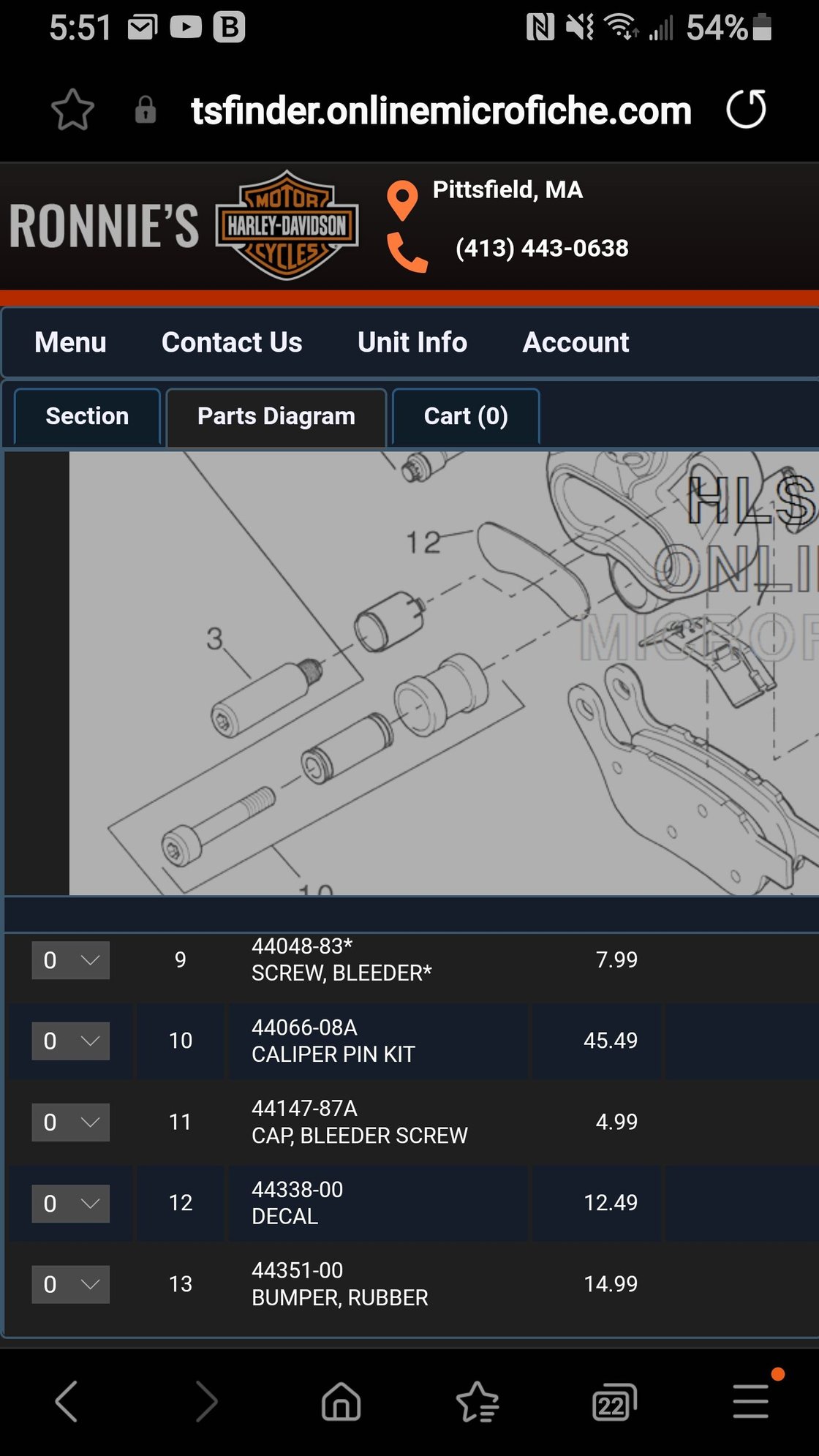

The rotor is fixed so they use a floating caliper setup. I know I felt the same. Its not a bad idea to replace the lower caliper pin kit, it does break down. Ive replaced it on my Dyna LRS and there's improvement if the rubber sleeve has broken down. #10 on the parts fische.

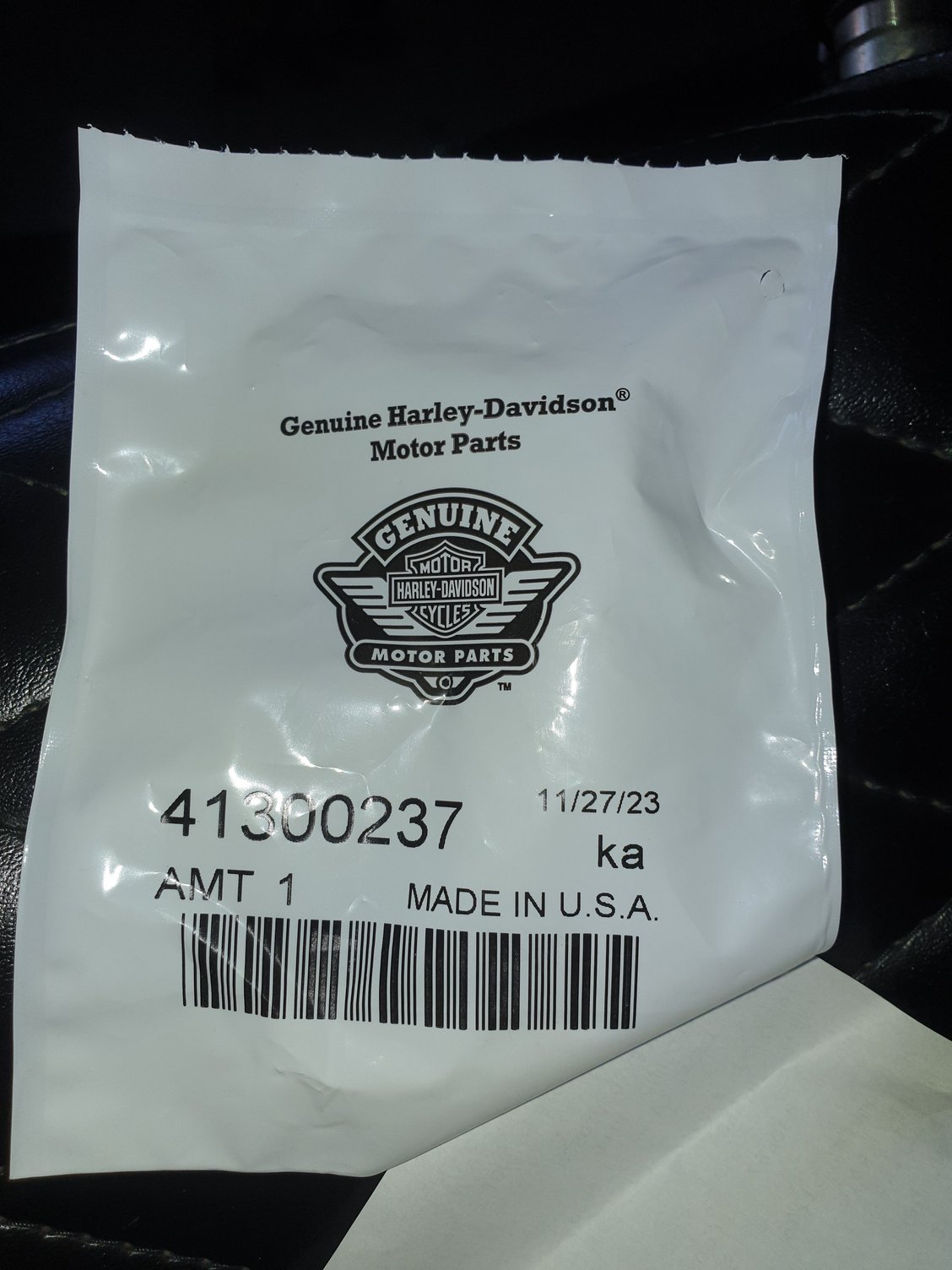

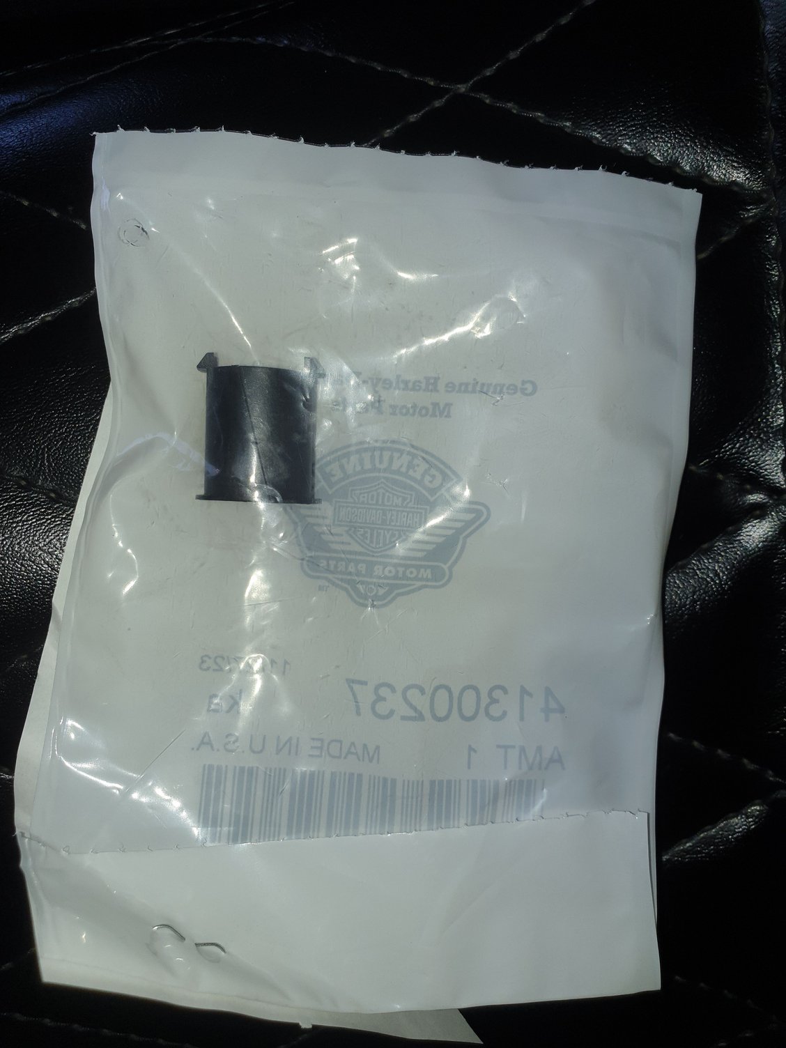

The other problem you have you're in luck. The plastic bushing deteriorates and Ive needed to replace it also. The plastic bushing isn't listed as a replaceable part on their parts fische and HD wants you to buy a new caliper as the fix. I was able to trace the actual part and number. Ive included pics for you of what to ask your dealer for. They will tell you to buy a new caliper if you just ask for the bushing.

👍 Now that is some great info 👏
41300237 ... $15.06 list price
