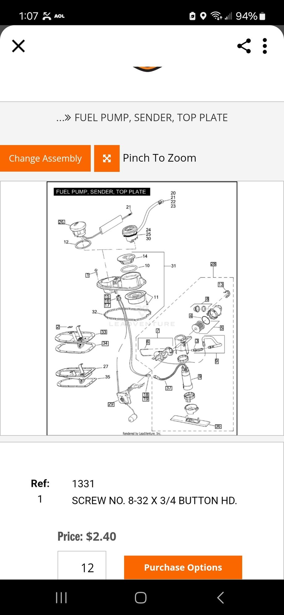

Hello all,
I've been restoring my 2010 FXDWG for some time now. It is basically a good machine other than some additions made by the previous owner that have been put back to stock. (Ape bars, risers, pipes. etc.)
That said, the one item that appears to be inoperative is the low fuel light. I understand that this is generated from the float position on the fuel level sender (75219-09). Obviously, I can replace this unit but before I do, I was wondering if there is the possibility of other faults that might be corrected.
I need to check the speedo for any code(s) but I've not yet done that (my bad).
Any suggestions would be appreciated.
Thanks in advance.

Yes, I discovered that the bulb for low fuel is present and working. Last nght I did a code check in the DIAG section with the reset button on the speedo and all of the lamps illuminated for an instant just before the DIAG section opened. (low fuel appears as a yellow gas pump).
That tells me that the bulb is OK and that the problem is downstream in the variable resistor section of the 75219-09 fuel pump sender inside of the fuel tank next to the pump. Apparently, part of the resistor track is either missing or corroded so that when the float is at the bottom (1 gallon or less, i.e. low fuel) there is no resistance sent to the speedo to illuminate low fuel.
By the way, the only "code" received was P55Pe6. (top of "e"missing) Both Google and other HD sites tell me that this is not a code. LOL
So, once the sender is removed, I will test the resistance pins for the fuel gauge with my VOM and see where the fault lies. The senders are available on eBay and elsewhere both new and guaranteed good used. I have all of the manuals, e.g. Electrical Trouble shooting, etc.
