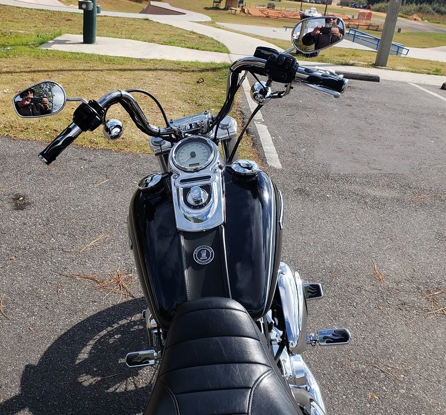

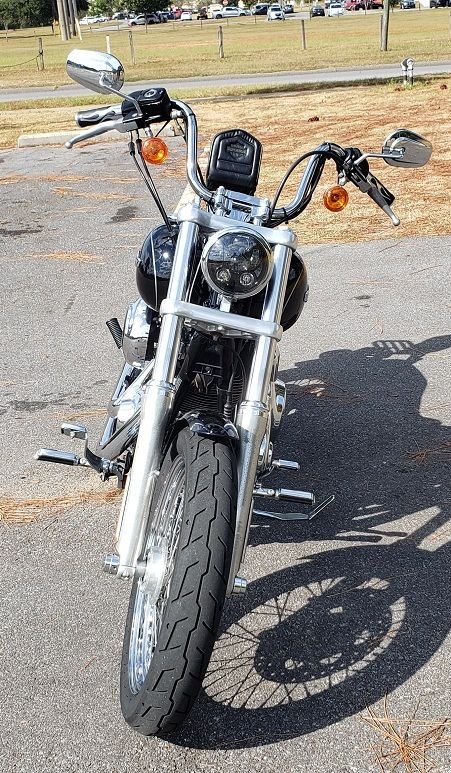

TC Bros. 1" Narrow Mini Apes Handlebars 8" Chrome - Dimpled.
2011 FXDC
