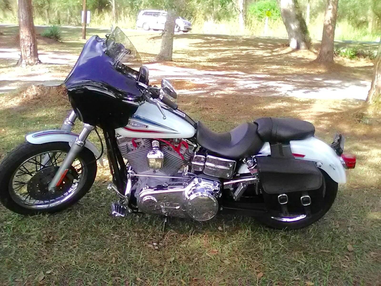

Memphis Shades for my 2006 Dyna Super Glide FXDI35
This doesn't look too bad! How is it in terms of wind buffeting? Does it make a difference? Do you think it'll work with 10" bars?
This is detachable, yes? Got any pics from the front?

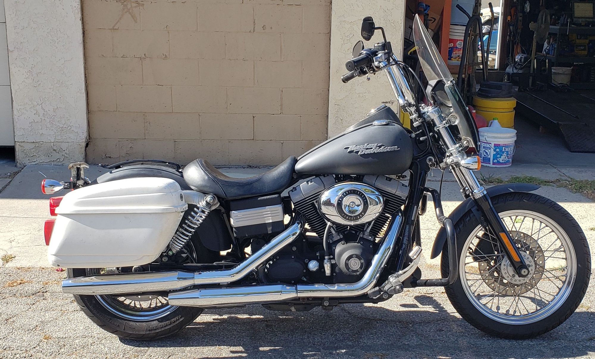

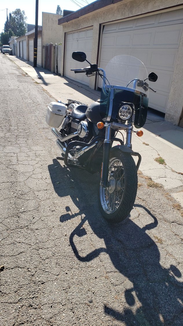

This works to keep the wind off your chest as well as the bugs, Uses HD quick detach clamp style mounting. The shield frame is from HD and the mounts, the plastic is Memphis Shades.
Tom

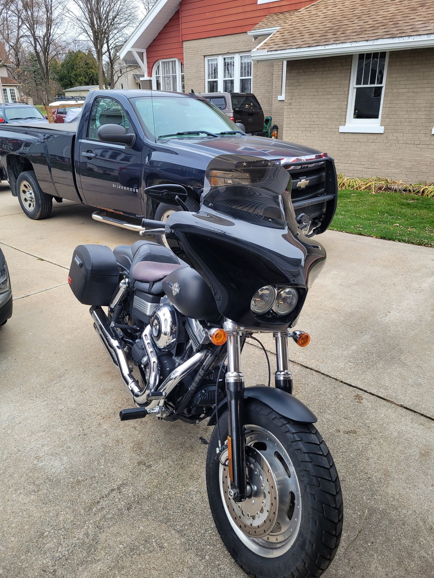

I had both the Harley quick release windshield and now the Memphis Shades Bat Wing and the Bat wing is the best for me , and I do a lot of long freeway miles etc for my regular work commute . A windshield is better than no windshield

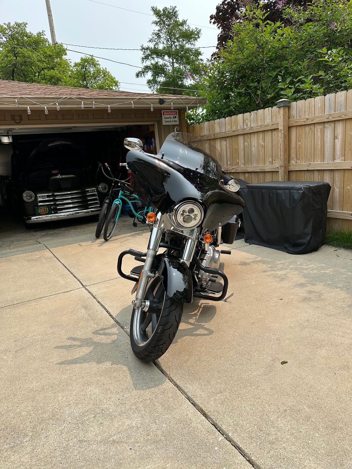

Switchback with a Memphis QD fairing
