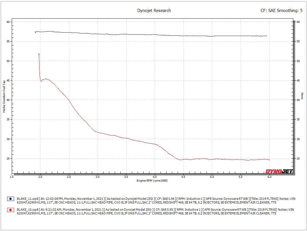

I don't know if it's supposed to drop to 30 while cranking. If you can, check it while riding as pressure can drop as rpm goes up. Here's good vs bad.

Me? That's fuel pressure, before and after filter and regulator.

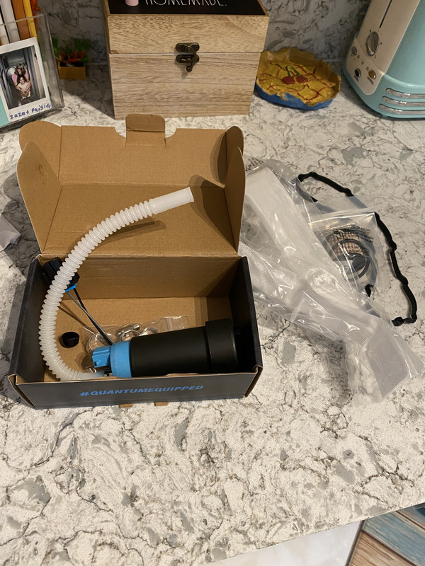

Changed out the engine temp sensor just to see if it starts better tomorrow. We shall see in the morning. I am thinking the problem is in the tank. Ordered a new pump, regulator, filter, screen and gasket. Also ordered new bolts for the top plate. Should be here this weekend but I am out of town until next weekend starting tomorrow.

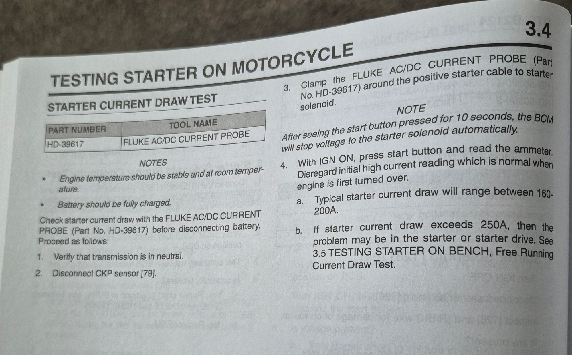

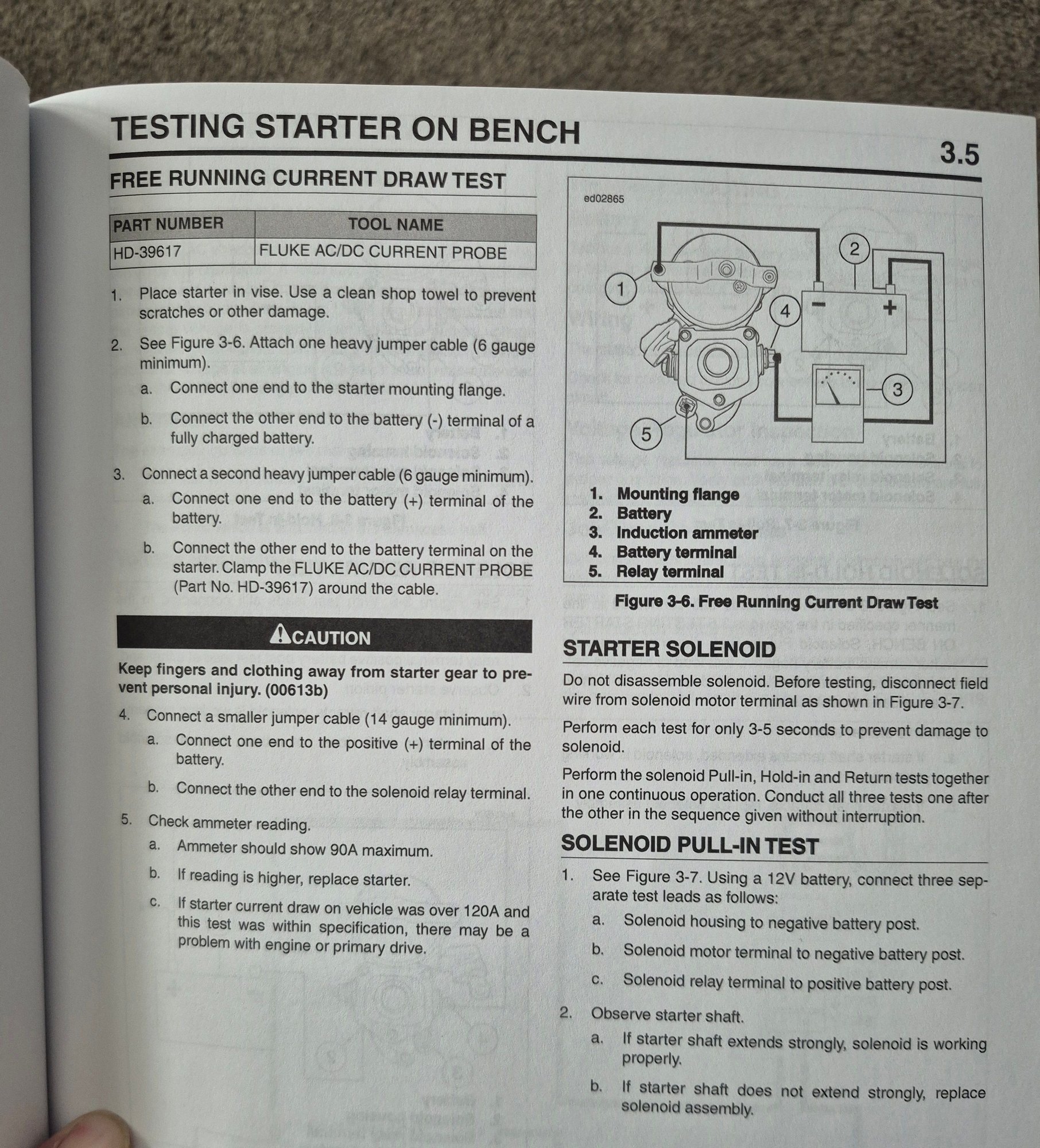

I just got my new to me 2013 electric diagnostic manual and I will post up pictures of doing a current draw test on the bike or on the bench. Any clamp on amp meter will give you the information you need to do the tests.

Had some free time. New pump, regulator, filter and screen went in. Seemed to do the trick
