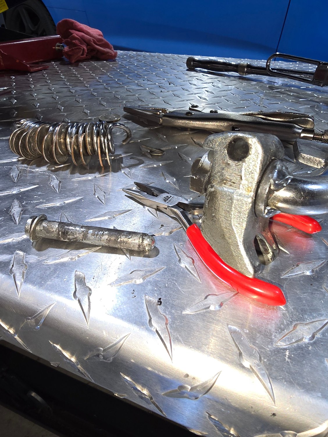

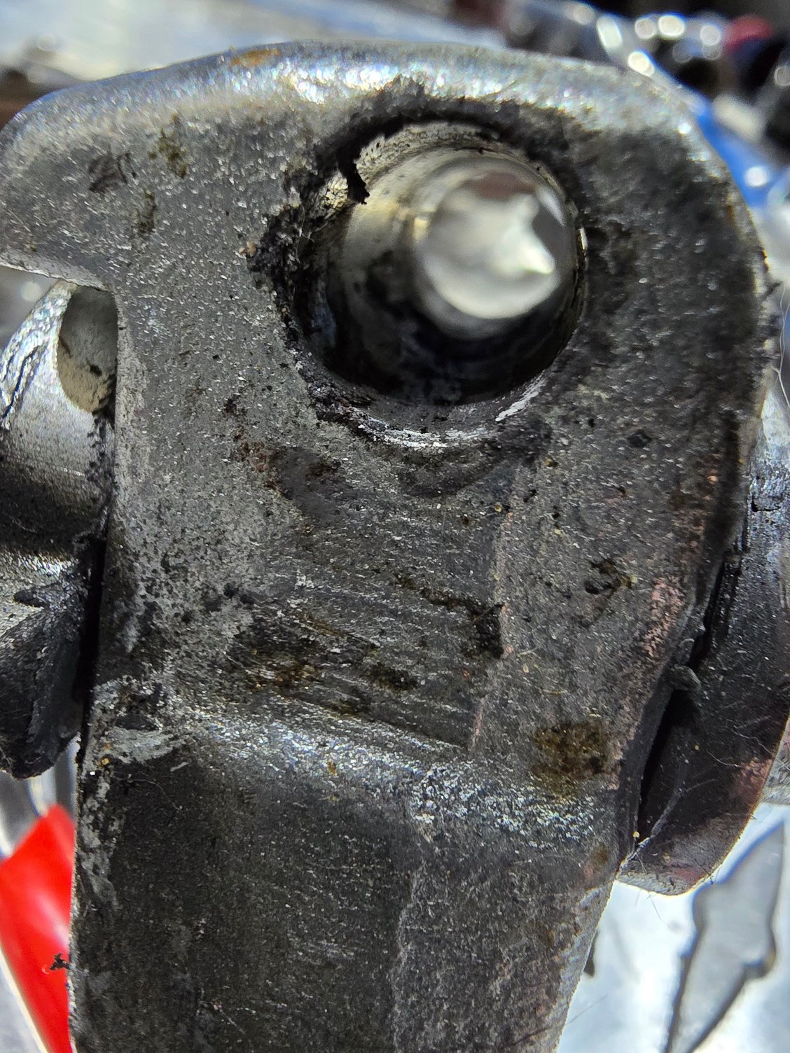

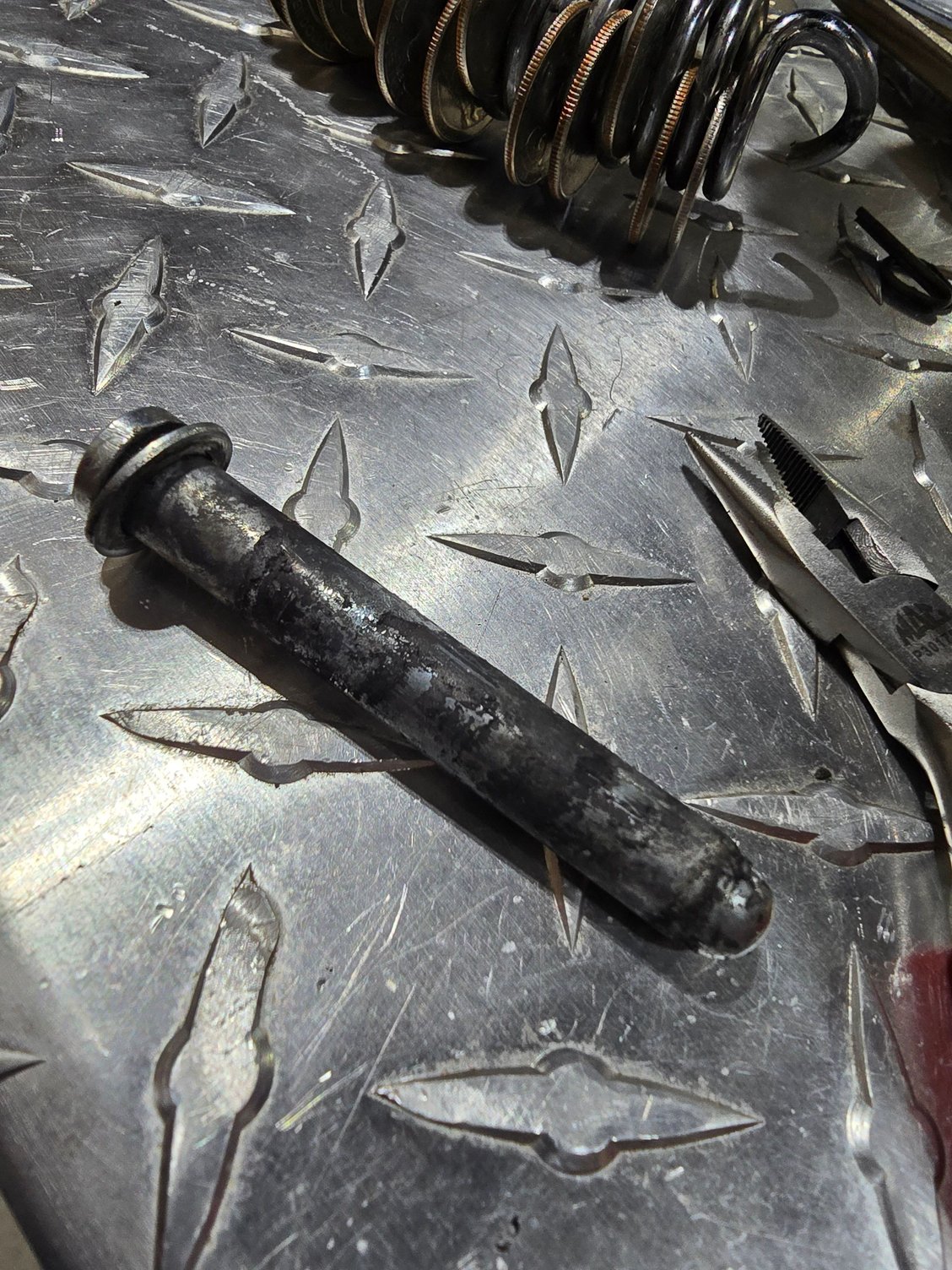

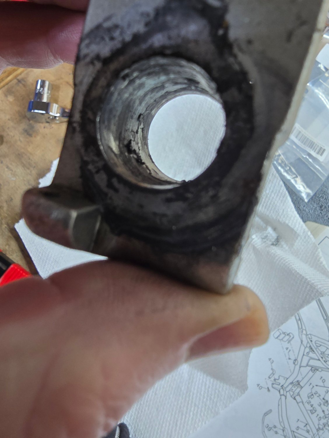

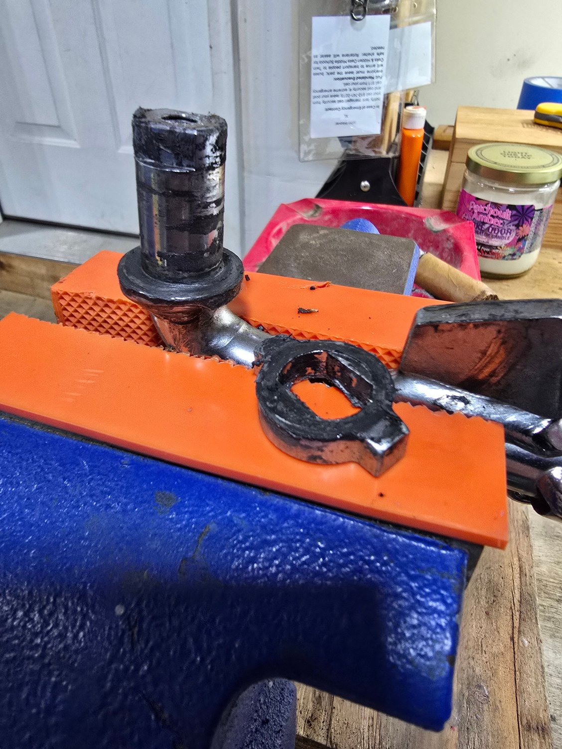

Well, that explains things.
I can't remember what kind of anti-seize I used when I rebuilt it a few years back, but I think it was the stick stuff, and it might have been copper? Getting old, don't remember. What was left was a gummy and, in some places, really hard substance with no lubricity. It also picked up a lot of road grime.
Going to go through it all get it nice and clean and take some fine sandpaper to the bad spots and reassemble with silver anti-seize (pic at the bottom), the brush on stuff. Hopefully that solves it.

I notice something in your pictures that you may want to pay closer attention too.
I agree that whatever you used to lube the stand before likely wasn't doing you any favors.
But I also see where you are placing coins in between the coils of your spring.
I assume this is so you can get the spring installed.
However, there really isn't any need at all for doing that and it could cause some stretching in the spring that is not good.
Here is a video that shows you how to very easily install the spring without any coins or stretching.
