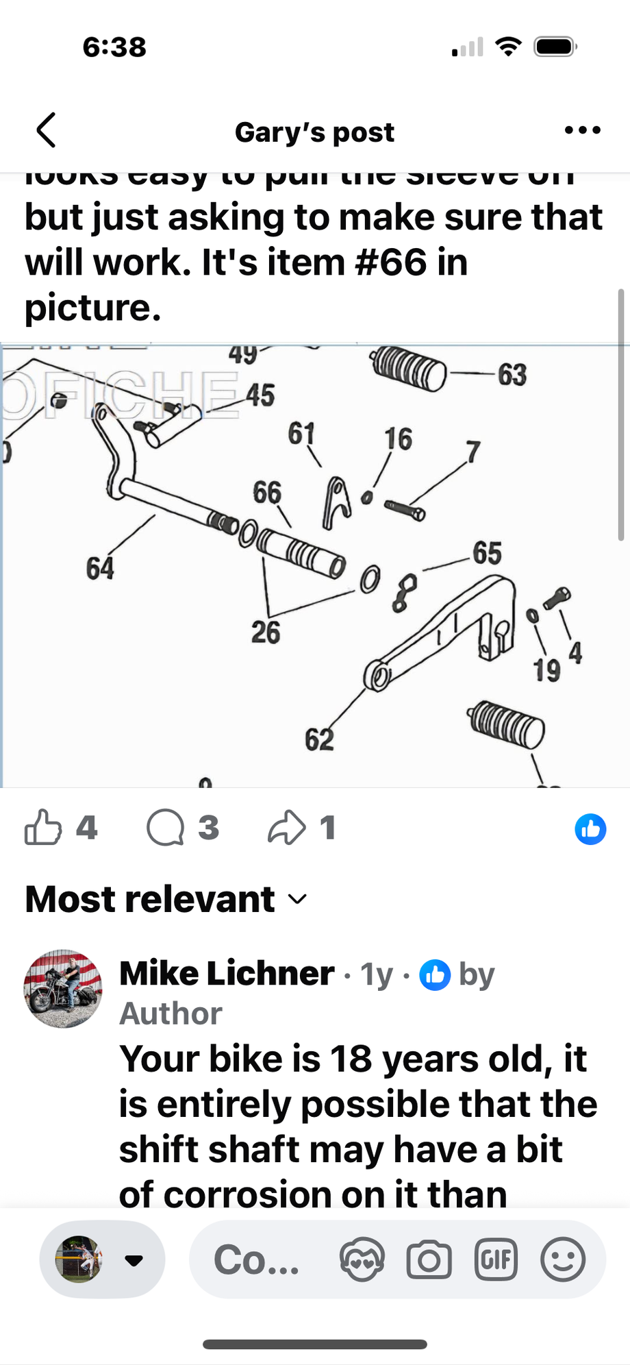

I have a ‘96 Fxds with a sticky shifter. Initially I thought I had a broken shifter pawl spring that is NOT the case. The bike was given to me after sitting outside for 12 years. I assume there is corrosion on the shift shaft and plastic sleeve inside the primary.
Any suggestions on getting this sleeve off without pulling the inner primary. I am able to tap the shift rod inward until it hits the lower end. I don’t want to get carried away with too much force of the plastic.

The outer primary cover must be removed to access the plastic sleeve. It's not a difficult job as long as you are mechanically inclined and have a Factory Service Manual and the necessary tools.
