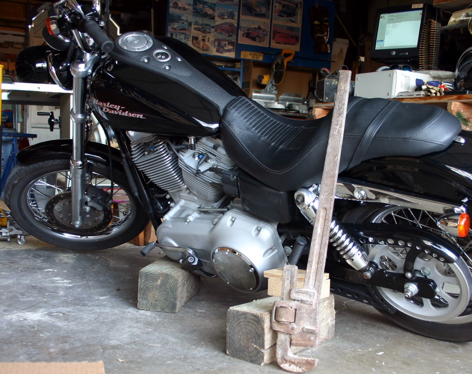

Here's my techniques for leaning the machine way over
to more easily access any operation on the underside.
Or, the once a year greasy side cleanup.
As you see, I'm due for that procedure now.
Place the front block diagonally and bridging from Downtube
and over to Primary Housing and Footpeg Bracket.
Rear block under the end of the Rear Footpeg Bracket.
This will lean the machine way over.
Front tire is about two inches off the floor.
Rear tire is on the floor.
Proceed with this one carefully,
and don't blame me if you fork it up.
Check the balance before you get away.
Shown below, you can see under and get in with tools easily.
Another technique, not recommended,
unless emergency on the road situation comes up.
Just lay it over in the dirt.
A week or so ago, I was riding through a big caliche parking lot.
It had been raining a few daze before, and I didn't see a wet area,
the sun had slightly crusted the mudpuddle over,
so it was camouflaged the same color as the dry surrounding area.
As soon as I got there, about 5-10 MPH,
the machine dumped over on the pipe side.
A friend riding behind said it went down so fast
he didn't even have time to enjoy (watching me go over).
I only got my shoes muddy up to about three inches,
but I gotta tell you this -
it ain't easy to clean that clay off the pipe wrap.
continued in posting #686.......

I have done the tipping thing too, but instead of tipping it over on blocks. I use a pair of tow straps hung from a stout overhead beam. It lets me safely tip it over as far as it will go without worring aboutthe bikes balance.
A friend does the same thing but uses his engine lift. Its strong enough to physically pick the bike upoff the floor if necessary.
BTW I think you should quickly update your gallery and check out the newBOTM thread.
https://www.hdforums.com/m_2939022/tm.htm

As to balancing on my lean over technique,
I did say you should check carefully.
Note below, front tire is off the ground,
and the machine is safely planted on the rear tire,
and the two timber blox -
Gotta love the South Texas winters.
For a positive measure of insurance I may strap to one of the anchors
I implanted in my concrete drive -
Below, the annual under clean makes a big difference -
before -
closer shot added for reynolds............
