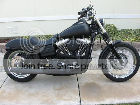

Just fitted a set of Hagon shocks to my bob. They tailor make them to your weight andcost ÂŁ169 (about $300)night and day! Can't believe the difference they make!
I kept the standard length as imo the stock shocks don't have enough damper travel as it is and shortening them would make it worse.
[IMG]local://upfiles/39297/98776CB25F234FF982ECDDC35F1B7470.jpg[/IMG]
