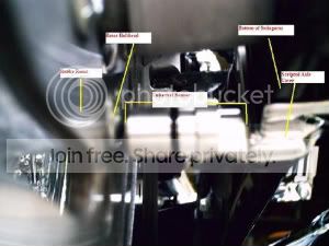

I installed a Diamond Digital (Dakota clone) electronic speedo on my 06 FXDI.
I mounted my speed sensor on my swingarm and positioned it so it would pick-up on the rotation of the rotor mounting bolts. I did it this way based on what someone else did to make his work. He drilled a hole in the swingarm to mount his. I didn't want to do it that way and have a permanent scar from the install, so I mounted mine differently. I have rear axle covers and used the lower mounting bolt from the cover to secure my sensor. Here are a couple pictures. Sorry they are not real clear.

which unit did you purchase? They should would work with any electronic speedo, huh?

The Diamond Digital speedo came with the speed sensor I used. It is just a universal unit, similar to what you can get through Dakota or other manufacturers.
