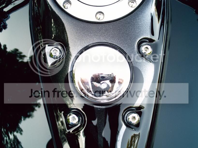

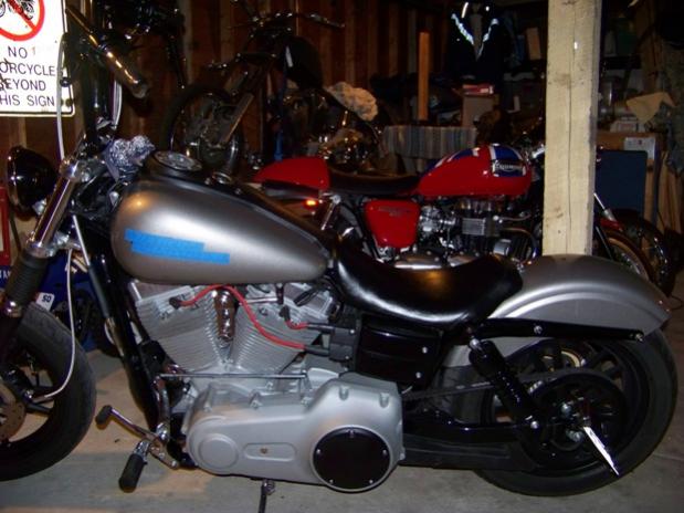

Default Ignition Pics
Cool, thanks...that will help with wiring. I found an old ignition from my shovelhead and think I have it going. I used the bracket from the back of my horn and inserted the ignition.
