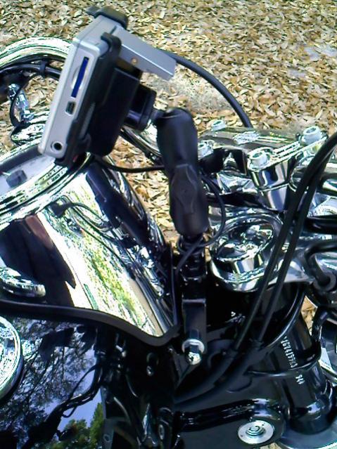

Here's what I did after reading through this awesome forum.
Purchased the SAE To Cigarette Socket adapter from Powerlet Equipped, plugged my battery tender plug into it and placed it under the seat, then ran the wire up under the tank to the front. I built the bracket out of some metal from Home Depot and also picked up a longer bolt to go through the new bracket and tank. Painted it with a gloss black spray bomb. Used a Ram Mount setup to hold my Nuvi 660. Now I have maps and music. Works great and I don't think it looks to bad either.
RT
That mount looks great. Even better then the ram mount I have mounted on my handlebars where your center cap is.
