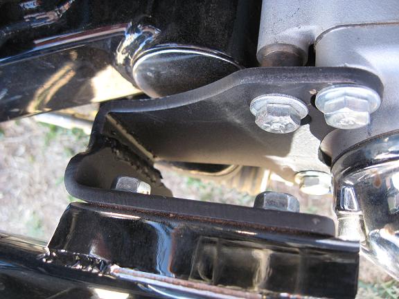

Sweet. I almost bought a set of those. I chickened out though.... was worried about trying to modify the mounting bracket. Was it difficult or what? I know you explained it elsewhere, but I'm tired, hungover, and don't feel like searching.

The bracket was a breeze. I just cut in half, bolted one peice to the pipes the other to the tranny, built a spacer with 1/4 ID steel tubing then tacked it up. Took it apart finished welding it up and walla. Had to elongate the hole with the spacer in there too.

I could have made it look better and have cut it perfect for a butt weld, but lapping it like that sure makes it quick.
