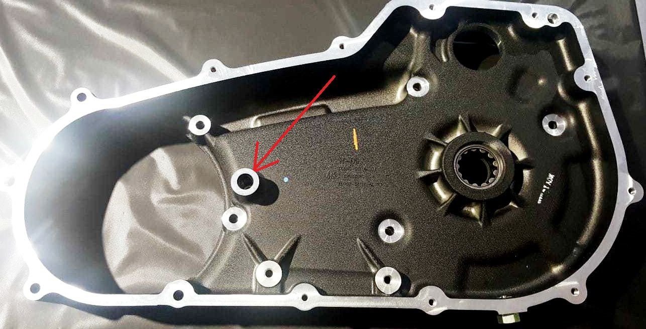

So has anyone ever done a write-up for changing to mids on a WG? I know I have to drill holes in the inner and outer primary but where exactly? Is there a template somewhere? A list of parts? I can't find any actual information online.

I wish it was that easy. You're going to have to get a new inner and outer primary. The mid control IP and OP actually form a tunnel that the shift shaft runs through, that's sealed with a round gasket where the two halves meet.
EDIT: OK, here's a couple of pictures that I swiped off of other threads here, that conveniently have arrows pointing to what I'm talking about. Those two round surfaces mate together with a round gasket to form a seal and keep the primary oil in, and the shifter shaft runs through the tunnel that they form.
There just happens to be an ad in the forum classifieds by someone selling both halves: https://www.hdforums.com/forum/motor...-controls.html
Good luck with your project.

Thanks. Yeah, it's just not worth it. Easier to just trade it in.
