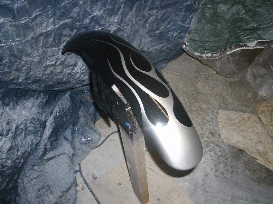

Got the paint/clear done . 5 coats of clear. Need some advice on what pimstriping paint to use over the clear and how to thin or what hardener. Any input I will be thankful.
Attached Thumbnails My Winter Project...-gedc0102.jpg   My Winter Project...-gedc0101.jpg   My Winter Project...-gedc0103.jpg

Nice paint job brother! you have some sick talent. i look forward to seeing the finished project.
